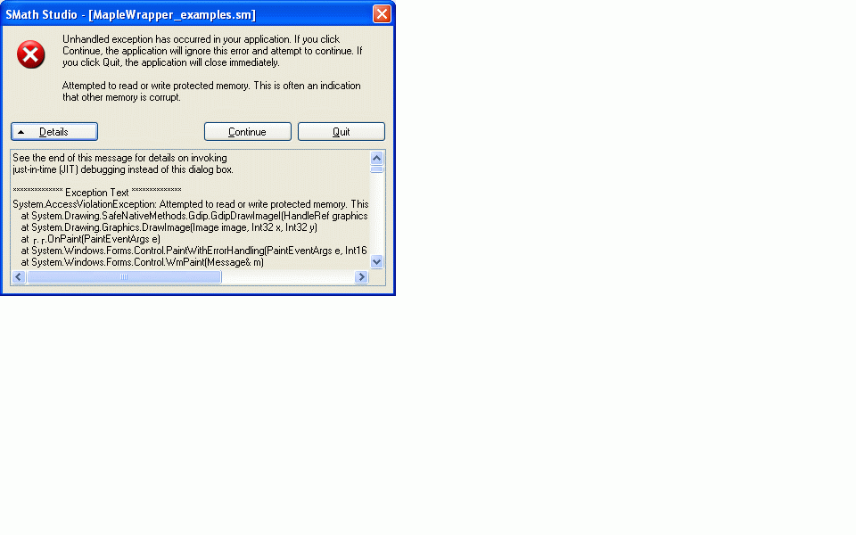

    #34 Posted: 5/8/2013 6:02:37 PM
    kaka
    kaka
    1 likes in 25 posts.
    Thank you, Andrey, for another update of your great program.
    Updated version with most external plugins
    This is the official linux version augmented by external plugins. Just for convenience.
    Tested on x64 under Win7, at least, there is no complaint on startup and the functions show up. There was just a single conflict: I had to switch the DataExchange Plugin to compact version (without Excel support).
    I got this error when I opened a second Smath
    It seems that it only happen to my another PC which has been just reinstalled.
    after updating all the patches I still have this problem. Why why why
    See the end of this message for details on invoking
    just-in-time (JIT) debugging instead of this dialog box.
    ************** Exception Text **************
    System.AccessViolationException: Attempted to read or write protected memory. This is often an indication that other memory is corrupt.
    at System.Drawing.SafeNativeMethods.Gdip.GdipDrawImageI(HandleRef graphics, HandleRef image, Int32 x, Int32 y)
    at System.Drawing.Graphics.DrawImage(Image image, Int32 x, Int32 y)
    at ..OnPaint(PaintEventArgs e)
    at System.Windows.Forms.Control.PaintWithErrorHandling(PaintEventArgs e, Int16 layer)
    at System.Windows.Forms.Control.WmPaint(Message& m)
    at System.Windows.Forms.Control.WndProc(Message& m)
    at System.Windows.Forms.Control.ControlNativeWindow.OnMessage(Message& m)
    at System.Windows.Forms.Control.ControlNativeWindow.WndProc(Message& m)
    at System.Windows.Forms.NativeWindow.Callback(IntPtr hWnd, Int32 msg, IntPtr wparam, IntPtr lparam)
