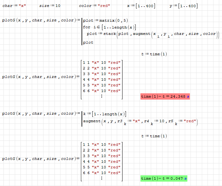

5 min 25 s (win 10 x64, intel i5 quad core 2.40GHz)
#28 Posted: 2/16/2018 3:07:54 PM
reduced to 30-35 seconds using ranged indices to replace stack/augment/submatrix (most heavy operations were in stack/augment under loops)
InterX.r1 - ranged indices.sm (87.61 KiB) downloaded 1172 time(s).
Andrey Ivashov 2/16/2018 3:13:00 PM
#29 Posted: 2/16/2018 3:11:46 PM
2,343 likes in 4,043 posts.
18 seconds on my env.
Great! Thank you Davide!

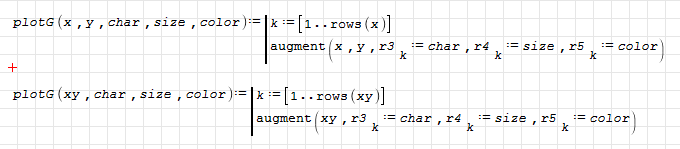

#30 Posted: 2/16/2018 3:49:26 PM
BTW, I would suggest to use another version of plotG which is much faster then previous one (and simplier):
plotG(x,y,char,size,color):line(k:range(1,rows(x)),augment(x,y,el(r3,k):char,el(r4,k):size,el(r5,k):color),2,1)
plotG(xy,char,size,color):line(k:range(1,rows(xy)),augment(xy,el(r3,k):char,el(r4,k):size,el(r5,k):color),2,1)
Davide Carpi 2/16/2018 8:54:00 PM

#32 Posted: 2/16/2018 4:45:48 PM
I don't replace plotG because don't understand very well that syntax.
It is simple - ranged indexes used.
Just take a look at the speed:
#33 Posted: 2/16/2018 4:59:17 PM
Thanks for the explanation, now I see the speed increment, and I don't think that it could be that big difference before you show it.
But actually the plotG(4) routine was which confuse me. I prefer
plotG(xy,char,size,color):if(cols(xy)>1,plotG(col(xy,1),col(xy,2),char,size,color),plotG(Re(xy),Im(xy),char,size,color))
because I think that any good plot implementation must to use complexes but not couple of reals. So, if xy argument have only one column, one can assume that data are as Z = X + iY.
#34 Posted: 2/16/2018 5:08:15 PM

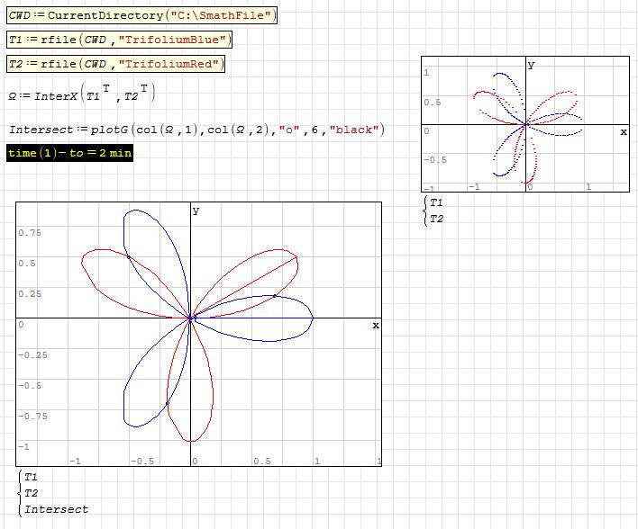

#39 Posted: 2/18/2018 10:58:48 PM
Hello Marco,
I'm trying for the intersection of the two Trifolium, .
blue => native ... red => rotated.
They are created in "Page1 Trifolium.sm
Then recalled for the InterX(T1,T2)
Nothing happens >>> 1 hr ? [Win 7 Starter Edition ... 1.66 GHz]
Is it supposed to work ? Thanks in advance.
Page1 Trifolium.sm (32.5 KiB) downloaded 1387 time(s).
Maths InterseX [Marco].sm (51.7 KiB) downloaded 935 time(s).
#40 Posted: 2/19/2018 12:26:16 AM
Hi Jean.
You are using an old version of the program. Try this one.
Notice that the point (0,0) is found several times by the algorithm. It could be interesting to check if it get the correct number of crosses at the origin.
InterX.r1 - ranged indices_alyles.sm (88.24 KiB) downloaded 1118 time(s).
