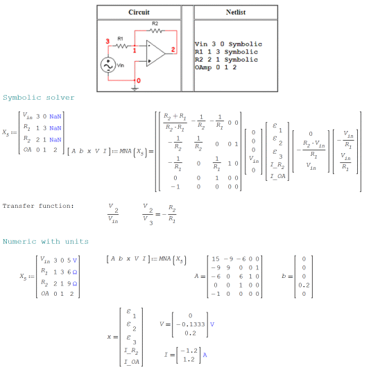

Hi uni. The attached shows that what you need to do that is get inside SMath the net list (and, yes, that's very old school). So, that's means that with some kind of modeler plugin you can get the net list and further process it with some SMath MNA solver, and procedures for bode and others charts.
(example from https://www.swarthmore.edu/NatSci/echeeve1/Ref/mna/MNA6.html#Example%205 )
The MNA implemented can work with opamps, so, given the equivalent circuit for some transistors, you can implement them. What I can't do yet is implement diodes.
Notice that this technique not solve an ode, but get the transfer function.

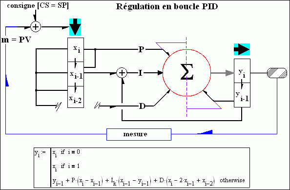

You really don't understand what we are telling, do you?
What if you really had to change the diagram or create a different diagram from scratch?

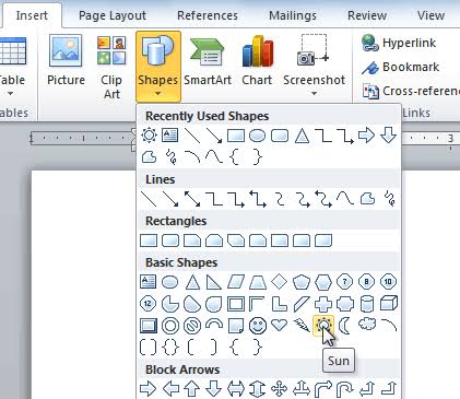

In the picture below, I had created your example diagram in MS Word using only shapes. Also added an additional step for you to understand.
It took me for 10 minutes to create it, and adding new step is only 5-10 seconds.
It is scalable and vectorial, you can easily add new items or remove existing without print quality loss.
You can also create it with Inkscape, Adobe Illustrator, etc. But please explain, why shouldn't we also do this inside SMath?

I understand and produce what the client team can visualize/sanity check, for them to solve/advance their demand. I was the sole Canadian single consultant for AECL [Atomic Energy Canada Limited ... not just a pet shop]. I appreciate what you can do otherwise, as long as you associate the maths that govern your new diagram. Your last circle ? comes from the maths that you have removed. In short, your diagram is crippled.
My original diagram represents a not visual working algo.
It complements the most common logic diagrams only useful for coding that needs no understanding the objective end use.
