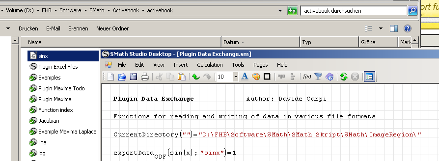

#22 Posted: 10/12/2013 11:25:11 AM
I don't know, how Davide managed to do this, but the DataExchange plugin somehow manages to handle relative paths with respect to the current document (despite the help text mentioning the current dir as default path).
In the attached screen shot you see a document, where a formula is exported using a relative path. The file is created in the directory of the currently open SMath document, even if that is not the current system directory (as can be seen in the CurrentDirectory() output).
May be the approach is not available for custom regions. Then a separate function like "DocumentDirectory()" would help, just as the function "SettingsDirectory()" from CustomFunctions, which is used to build the hyperlink targets in the activebook plugin index.

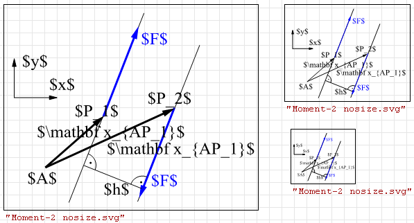

Ok, I'll think about it too. As for svg images, you can change the size of this type of images, but only if the dimensions are not specified in the file. Try these svg-files.
svg.zip (5.06 KiB) downloaded 470 time(s).
Radovan Omorjan 10/13/2013 3:02:00 AM
#27 Posted: 10/13/2013 3:14:46 AM
I tried your svg pictures uni. You are right, they can be resized but keeping their aspect ratio.
I suppose there is not a way to respect their aspect ratio by dragging the resizing either of the dragging markers (just asking). Actually, we can make it fit - if we want - by dragging the individual markers separately.
#28 Posted: 10/13/2013 5:51:21 AM
Thanks, this works. In my example, I just had to removing this: width="65.29mm" height="52.71mm"

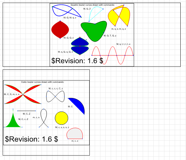

#29 Posted: 10/13/2013 8:22:58 AM
Updated. Added support for svg.
Great feature, thank you Viacheslav

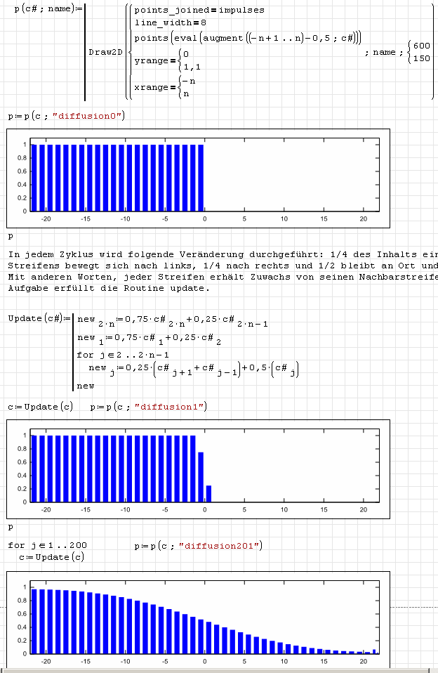

Is it possible, to evaluate the expression in the placeholder of the image region?
Then we would have a neat way to display Maxima generated images using the Draw2D() and Draw3D() functions as described here.
These functions return the file name of the generated image.

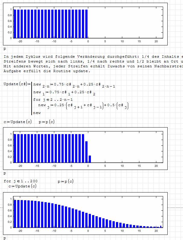

#32 Posted: 2/5/2014 9:11:13 AM
There is an svg rendering problem in the image region. The attached file displays differently in TpX, IE and SMath/Image region. Look at the rightmost line in the diagrams. The only correct rendering is by TpX. Of course, I cannot guarantee that gnuplot produces correct svg code. The gnuplot input files produced by Maxima are correct.
gnuplot_input.zip (1.14 KiB) downloaded 448 time(s).
#33 Posted: 2/5/2014 11:01:06 AM
Hello Martin,
Hmm...I might missed something, but I can not see the plots in the SMath "Diffusion.sm" file. I expected to see them (as usual) but the regions are empty and the *.svg files are not in the active directory (dir variable). See the picture and the log file please.
EDIT: Strange , I managed somehow to get those bargraphs - right bars were decreseing ( by moveing dir:= ). On the third one I saw th problem at the end - but can not reproduce anymore. Still empty regions???
EDIT2: It seems that Maxima restart and few recalculations will bring the plots (second picture)
