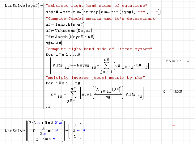

Here is a proposal for a unit-proof and user-friendly linear solver.
Davide, I propose to include it in the NonLinearSolvers plugin, perhaps as FindRoot(1).
- Equations can be specified using boolean equal with arbitrary distribution of linear and absolute terms to left and right hand side
- equations and unknowns can have arbitrary and different units
- no need for initial guess
- no need for specification of result units
I was not able to reproduce the embedded assignment feature in the example procedure. I would propose to enable that by default and perhaps provide an optional assignment flag.
Also, a linearity check (e.g. hessian-based) might be sensible.
The procedure LinSolve() looks more cumbersome than it ought to be, because of unreliable symbolic matrix inversion and multiplication. Fortunately, the alg() function works and thus the inverse can be computed with moderate coding effort.
LinSolve() provides an alternative for "hand made" sparse linear systems, as they typically occure in basic engineering mechanics. For densly populated systems, the matrix notation of the system might be more appropriate.

#144 Posted: 8/5/2013 12:47:12 AM
Janusz
Janusz
7 likes in 48 posts.
Martin!
Thank you for your perfect work and bright examples. This function will be very helpful for us when it will be included to the plugin.
The best regards,
Janusz
#145 Posted: 8/5/2013 5:30:01 AM
I agree with you completely . Your solution is quite educative and very interesting. A linear solver of this kind would be rather appreciated. We are also aware of unreliable Jacobian (derivatives) calculation, matrix inverse etc. Nevertheless, classical nonlinear solver approach could stuck if you give the linear system and try to force it in a nonlinear fashion. I suppose that you gave the idea to Davide how to make a basically linear solver. I just would like if there would be a possibility to incorporate into the solvers some kind of linearity check, like you said, and the option to solve it as a linear problem.
#146 Posted: 8/5/2013 6:26:24 AM
Thank you Martin, I'll add surely your code into the plugin
me too...

The only reason why I posted the issue here is that I see the proposed linear solver as a special case of the findroot function in the nonlinear solvers plugin. I am very happy with the user interface of this solver, in particular
- the flexible way to specify the equations (in close to natural notation)
- unrestricted use of units
- and the embedded assignment, which allows me to display and use the unknowns as soon as the solver was called, without any post-processing.
It is just laziness that I do not want to specify initial guesses when that should not be necessary.
With the term "sparse matrix solver" I had in mind just moderate systems with hand-written equations, let's say e.g. equilibrium conditions next to free body diagrams.
Some numeric libraries (like ITPACK) provide dedicated solvers for sparse matrices with elaborate storage techniques. This issue is by no way related to my proposal.
However, I would not mind the moderators to shift the discussion to a separate topic. For the time being I hope for ruthless testing of the proposed algorithm.

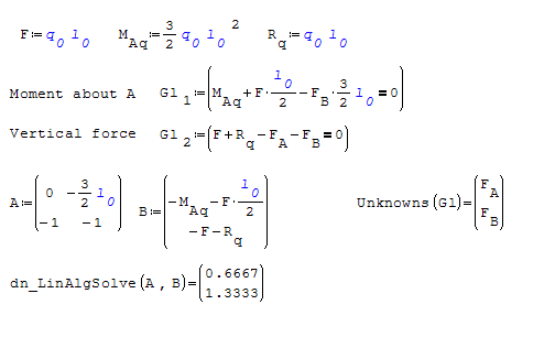

#150 Posted: 9/11/2013 5:11:44 PM
I found an example, where FindRoot() silently returns a solution that by far does not solve the given equations. It is ok that the solution may depend on initial values. In the given case, however, there is only a single solution and the wrong result is not converged. I have no idea what causes the problem. Setting tight error limits does not help.
Example Linsolve Beam2.sm (21.71 KiB) downloaded 1515 time(s).
Radovan Omorjan 9/12/2013 3:30:00 AM, Davide Carpi 9/11/2013 5:53:00 PM
#151 Posted: 9/12/2013 3:58:05 AM
Thank you Martin for this,
It is interesting to note that FindRoot() would take a considerable time to solve it with the appropriate initial guess (about 2min on my comp). I have no idea why FindRoot() gave the wrong results with some other initial guess (hope that Davide will find the problem). I also tried DotNumeric solver - see the picture please. The difference is regarding "units like variables" (no units here). The result might not be considered correct, and regarding that this is a numerical solver, I have no idea how dn_LinAlgSolve() escaped from this.
#152 Posted: 9/12/2013 3:46:27 PM
Let me just contribute a guess, Andrey may confirm or correct: Any unit that is not assigned to any dimension, is considered to be a base unit system on it's own. Thus, for procedures that cannot handle units, they are just set to one and the user must take care to assign the correct unit to the result. I do not think that dn_LinAlgSolve() has any provisions for handling this (uni, correct me if I am wrong).

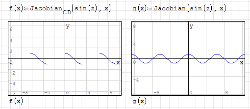

#159 Posted: 12/2/2013 8:02:24 PM
Jacobian.CD seems to be unstable.
Davide, do you have any valid test or demo file, describing the expected functions?
#160 Posted: 12/3/2013 8:48:22 AM
Thank you Martin,
you are right, I'll try to fix it...
