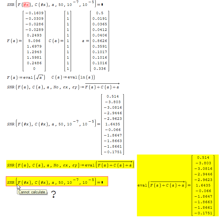

#249 Posted: 2/13/2019 7:25:01 PM
The troubles that I find solving this is that can't use the normal call for functions,
The "redooomed" downloaded but can't open yet. It might suffer same
auto-consumption than FindRoot, i.e: it does not clear itself within a for loop.
It must be called from an external forloop. Will post soon a semi-elegant way
of descending the FindRoot that needs several iterations as it is ± 3 decimals
from the Smath native module. I get 0.0000000000001 as final sanity solutions.
Takes ~ 5 minutes of manual iterations ... Jean is happy !
Cheers Alvaro.

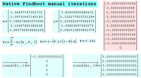

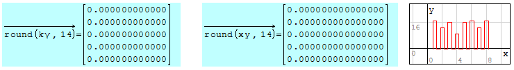

#250 Posted: 2/14/2019 12:44:31 AM
It seems that I am repeating myself periodically.
Like when you start speaking to yourself, indicates the Man is in good growing conditions.
That version is refreshed in 8 manual iterations, easy to use.
Start by the very initials [xo, yo]
Project Solve Flashing Copy.sm (209.05 KiB) downloaded 1578 time(s).

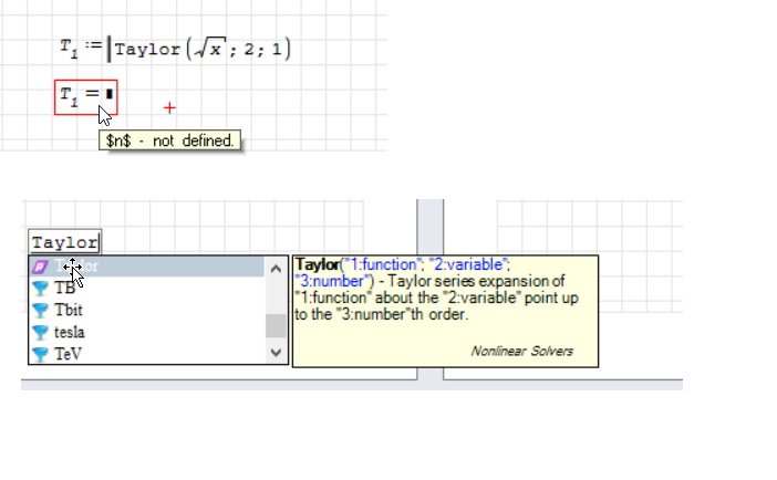

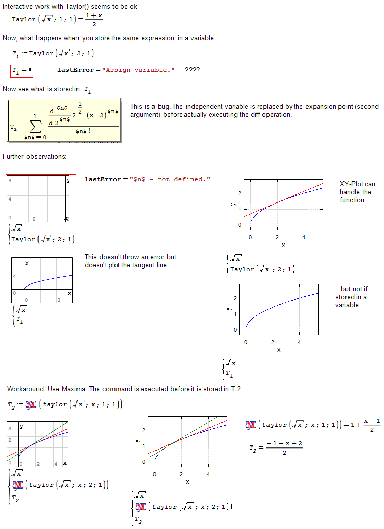

#253 Posted: 1/29/2020 11:59:54 AM
In build 7251, there is a problem with Taylor(), see screenshot. Bugreport filed as SS-4631
Taylor.sm (21.59 KiB) downloaded 1510 time(s).

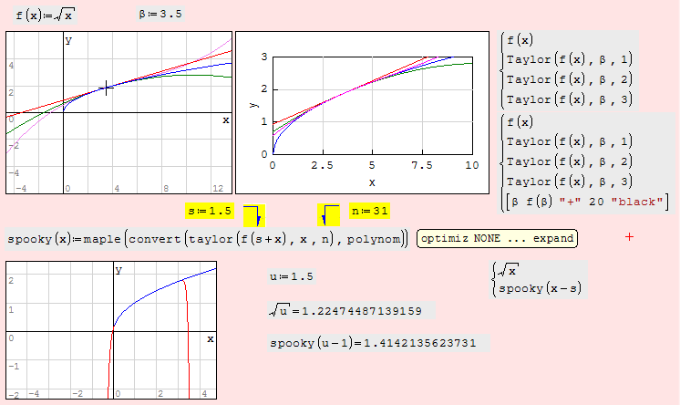

#258 Posted: 9/20/2022 10:18:18 AM
As far as Taylor is concerned, there is no bug in Smath.
Taylor is not a function. Simply a Classroom quick plot demo.
What it plots is not otherwise possible to evaluate.
However, you can play/productive with the spooky Taylor.
Cheers ... Jean ... hope it clarifies.

#260 Posted: 9/21/2022 11:58:53 AM
The missing document.
Maths Taylor Spooky.sm (20.43 KiB) downloaded 1556 time(s).
