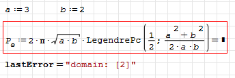

This error means that the second argument was out of bounds. The function checks the value of the arguments before calling.
