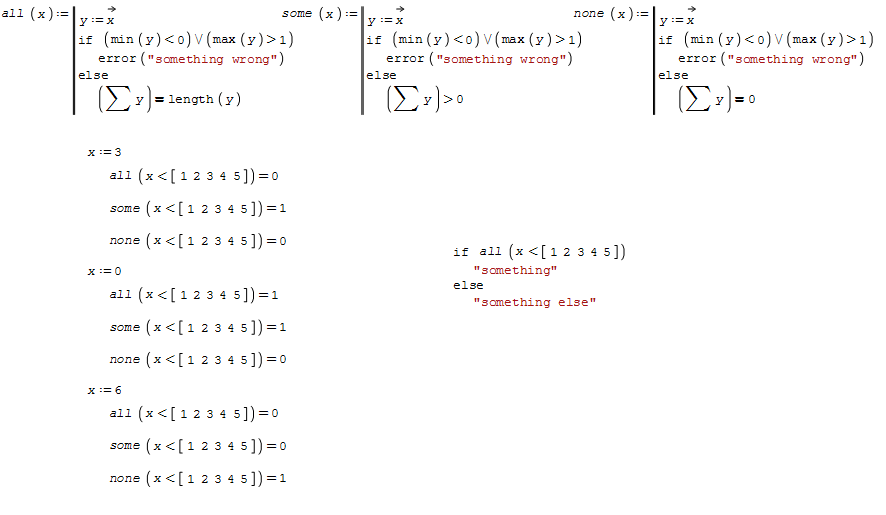

#5 Posted: 5/9/2022 8:37:41 AM
You can always create some function to make it look like you are working with some set of numbers
3 users liked this post
sergio 5/9/2022 10:55:00 AM, Alvaro 5/9/2022 11:19:00 AM, Arie 5/9/2022 4:16:00 PM
#6 Posted: 5/9/2022 10:06:38 AM
Tanks Davide ... coded/saved.
Take care ... Jean.
Maths Conditional Davide.sm (12.36 KiB) downloaded 1542 time(s).
sergio 5/9/2022 12:46:00 PM
#7 Posted: 5/9/2022 11:25:27 AM
Hi Davide. Great idea. These functions can be very useful for translating matlab programs. They can also be extended to arrays, as the all, any and nnz functions do.
