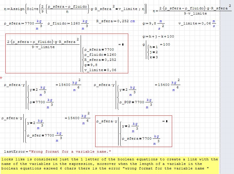

I am trying to use the at(2) to try to evaluate a formula with several variables in one step.
OK this makes quite no sense ...but is in an attempt much more difficult to use a same symbolical equation obtained through a solve in different parts of a documents with different values of the variables without using each time the technique of the disable evaluation ( at least is the only way I have found to address this issue ... it doesn't exist a command that allow to reuse a symbolical equation after some assignment have been done to the values of the variables referenced in it ).
However in doing this I have seen a strange behaviour of the at(2) as herewith reported:
See my comments in the screenshot.
Franco

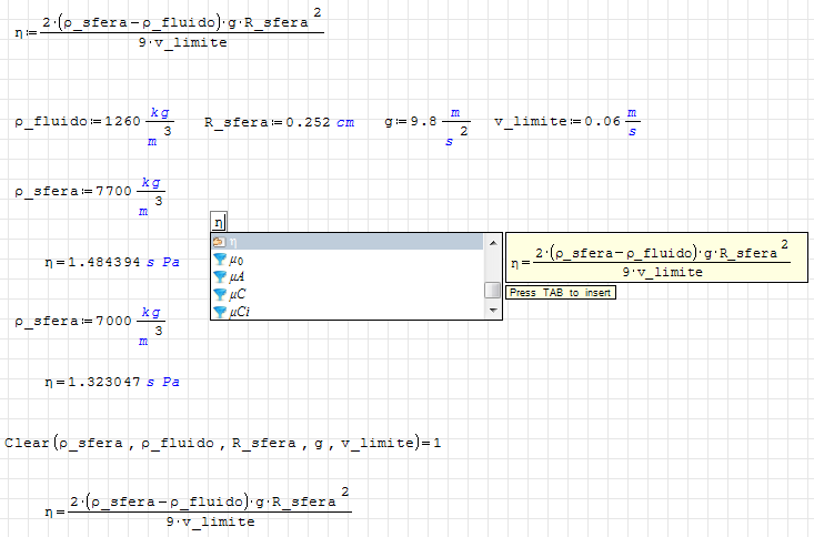

Once the variables are unknown at the definition of eta, you can reuse it any times you need, just define again the variables' values (search it in the Dynamic Assistant, you see that no numeric values are stored); use Clear(...) if you need to show again the unknown names.

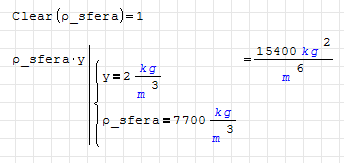

This is because in the second argument of at() you are using variables already defined, therefore at() reads "7700*'kg/{'m^3}≡7700*'kg/{'m^3}" instead of "ρ_sfera≡7700*'kg/{'m^3}" -> currently you have to use Clear(ρ_sfera); I plan to improve at() with progressive preprocessing, to reduce these kind of problems (and the error message too).

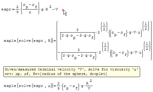

If you set your formula "mathematically"
[in this case as an implicit expression],
you will solve anywhere in the document
for any of the variable.

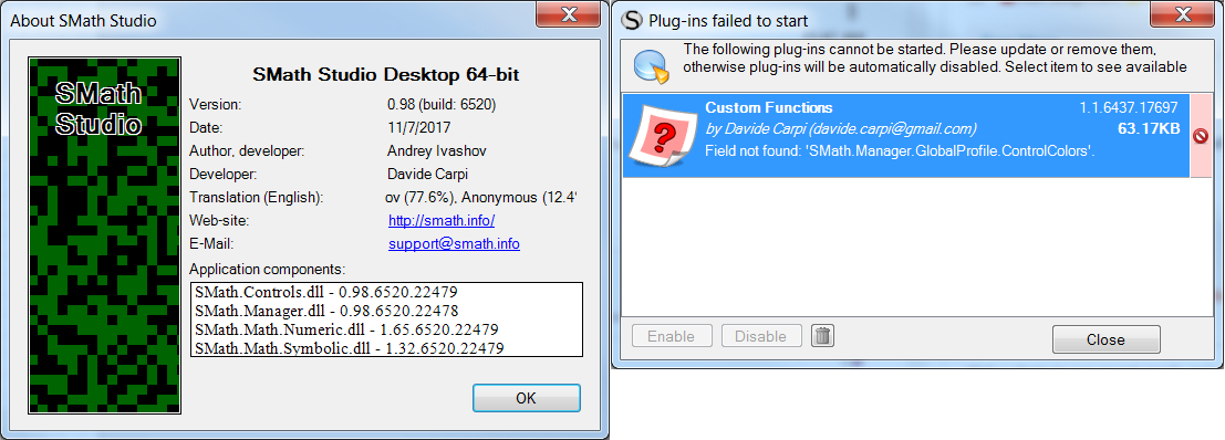

Hi Davide, ran across this error...
