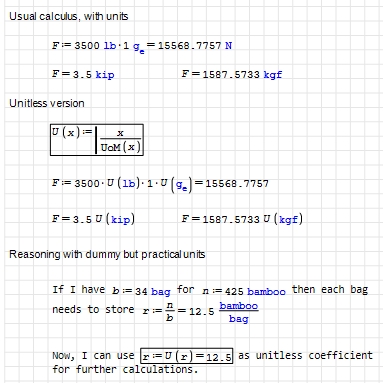

Hi. I agree. Here, a way to get that. Also, notice that you can use almost any other unicode symbol for U(x), or 'U(x), i.e. U in blue.
DummyUnits.sm (9.65 KiB) downloaded 1145 time(s).

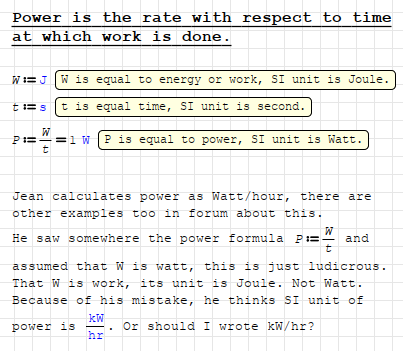

And sometimes that numbers tend to make serious mistakes, like that kW/hr pump power calculation of his.
Not even a typo, he divided 1hr (3600s) to g.e (9.8), found 367 and used it in that abomination.
I have never seen that kW/hr usage anywhere, but interestingly his pump power results have it.
It should even be kW, not even kW*hr. What will be benefit of pump electrical consumption calculation?
