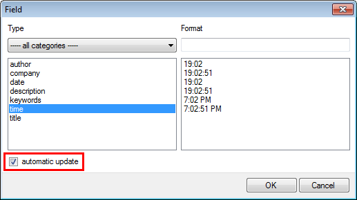

#62 Опубликовано: 16.10.2016 12:58:06
Hello Alex,
1. worksheet info field does not change if the actual smath file properties change
Yes, this is because the region is designed to have a low footprint and there isn't an event "File Properties Changed" for the worksheet; but I see that it doesn't changes even on file opening nor for region paste; I'll investigate it ASAP.
2. date changes the moment smath worksheets is re-opened
Is there a particulat reason for this behaviour?
I suppose is matter of my habits; if I need a static date/time I write it directly or I convert the field to static text. However I realize that one might want it "less dynamic". What if I add a property for each field to drive the update? (whenever possible or just manual by context menu).

#64 Опубликовано: 02.11.2016 14:57:10
PLUGIN UPDATED SMath Studio 0.98.5935 and later
  • Rendering logic refactored to be much more fast (smooth worksheet's scroll on huge regions or even on multiple regions intersecting the viewport);
  • Applied correction on characters' spacing to make them closer to common text editors;
  • Fields: added option to disable automatic updates;

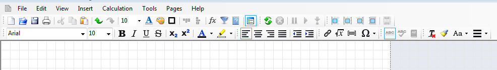

#66 Опубликовано: 03.03.2017 16:41:07
Ruben Sidranski
Ruben Sidranski
Davide,
Under version 0.98 build 6179 (64 bit) loaded, this plugin does not work as it used to. It used to be that CTR+Shift+W would pop open a "formatting" dialog box (per post #2 "floating toolbar") like the text region utilities. Now it just opens a "text box which is the width of the sheet, but no formatting utilities. Is this because 64 bit loaded up when I upgraded?
PS Same issue with portable version I created with previous version. Can shis toolbar be placed in the side panel with the math/symbols, etc.?
PPS If I left mouse click and go to settings, the floating toolbar pops up. Is there a way to make this the default? (both desktop and portable)
#67 Опубликовано: 03.03.2017 20:55:19
Davide,
Really strange
Only cases in which you should notice changes are on cleaning of settings folder (but this will load the default settings, that aren't the ones listed by you) or by your choice. Please check your settings in the "More..." > "Options..." menu ("New regions" and "Environment" tabs). Settings should be saved once you click on "OK" and never change, except in cases mentioned previously.
Nope. Since next SS relase should be possible to create plug-ins to have more toolboxes, but this won't be the place for Writer Region toolbars.

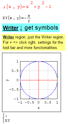

My procedure Win 7, micro laptop:
1. from the insert menu => click the W symbol [insert writer region]
2. the empty rectangle appears [|]
3. click right for the drop down menu => click left "settings"
4. as you start typing in the rectangle the movable tool bar is active.

#71 Опубликовано: 17.03.2017 10:57:52
Ruben Sidranski
Ruben Sidranski
Jean,
That is the problem! The movable tool bar is active only after doing all that. It used to pop up @ step #1.

#74 Опубликовано: 17.03.2017 22:21:52
That is the problem!The movable tool bar is active only after doing all that.It used to pop up @ step #1.
Once you have entered the writer region you have minimal options:
click on a word to Ctrl+B, Ctrl+U [bold, underline].
For the tool bar: click right, click left on 'settings'.
The minimal and advanced options is very ergonomic [to me].
