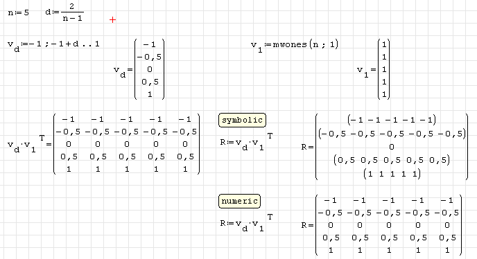

Is there a chance to return scalars if the result matrix has 1x1 size by default (without touching each function separately)? Then we could use all the functions as direct replacement for the standard ones. The drawback would be that these functions cannot handle lists (except if you can recognize that in the plugin and do sys2mat and vice versa.
One could even think of working with any nested structures by flattening them out internally and afterwards restructuring the results according to input.
I guess that unit handling would not be trivial. However, for most special functions this is irrelevant anyways.
WroteWorks here.
Updated. Done. As for the rest, I'll think about it.

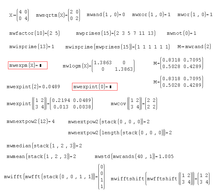

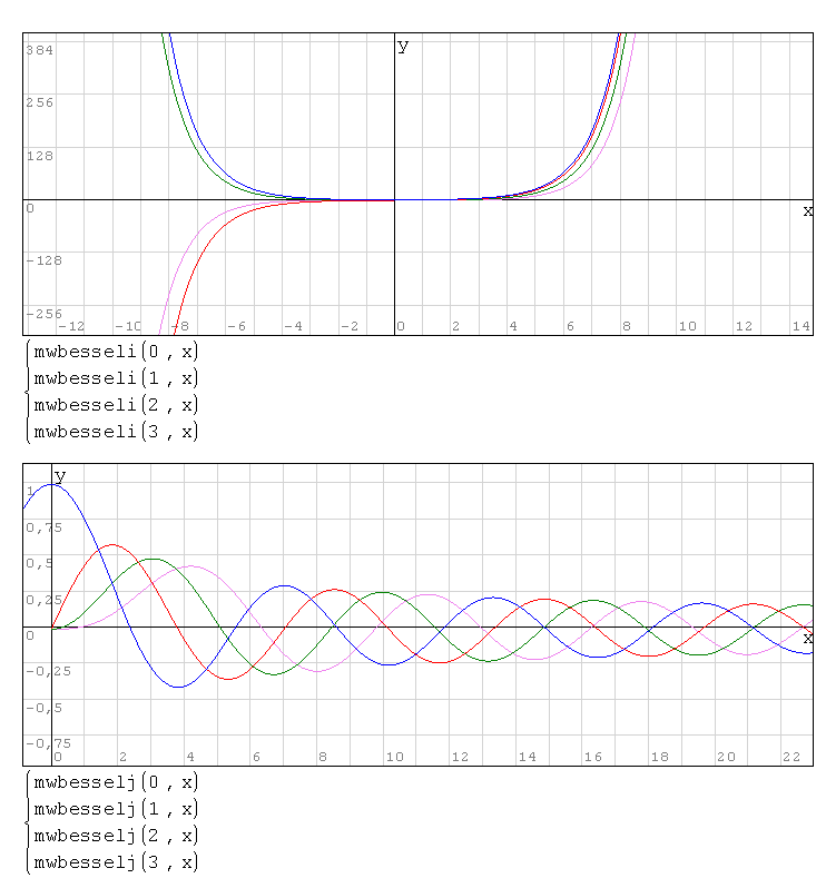

WroteUpdated. 83 functions (see log.txt in the plugin folder).

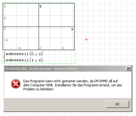

I tried it first and could see that mwbesselx() functions do not work. Then I checked the log.txt file.
This is the end of it
8/25/2013 12:35:58 PM [INFO ] [Plugin.Initialize()] Successfully. 83 functions loaded.
8/25/2013 12:39:34 PM [ERROR] [Plugin.NumericEvaluation()] mwbesseli(2) Exception has been thrown by the target of an invocation.
8/25/2013 12:39:51 PM [ERROR] [Plugin.NumericEvaluation()] mwbesseli(2) Exception has been thrown by the target of an invocation.
8/25/2013 12:39:56 PM [ERROR] [Plugin.NumericEvaluation()] mwbesseli(2) Exception has been thrown by the target of an invocation.
8/25/2013 12:41:32 PM [ERROR] [Plugin.NumericEvaluation()] mwbesseli(2) Exception has been thrown by the target of an invocation.
8/25/2013 12:41:50 PM [ERROR] [Plugin.NumericEvaluation()] mwbesseli(2) Exception has been thrown by the target of an invocation.
No success with mwbetainc() yet as well. I suppose you know all this, just wanted to confirm.
25.08.2013 14:18:54 [ERROR] [mwbesseli] Failed to load MEX-File : besselmx.
25.08.2013 14:19:00 [ERROR] [mwbesseli] Failed to load MEX-File : besselmx.
25.08.2013 14:19:09 [ERROR] [mwbesselj] Failed to load MEX-File : besselmx.
25.08.2013 14:19:16 [ERROR] [mwbesselj] Failed to load MEX-File : besselmx.
25.08.2013 14:19:20 [ERROR] [mwbesselj] Failed to load MEX-File : besselmx.
25.08.2013 14:20:55 [ERROR] [mwbesseli] Failed to load MEX-File : besselmx.
and I get an error message from SMath (translated)
The program cannot be launched because DFORMD.dll is missing on your computer. Re-install the program to solve the problem.
such a dll is present on my system as part of the ANSYS finite element package.

I can confirm that mwbesselx() functions are working for me

When you assign a matrix generating function to a variable, then this is done symbolically by default in your plugin. Thus, a random matrix looks differently every time it is used. This behaviour is different from Davide's Statistical tools, where numeric evaluation seems to be default.
I guess that symbols with changing contents at every use are somewhat unexpected for the user. Therefore, I would therefore recommend to set evaluation to numeric by default, unless there is something to gain from symbolic evaluation (which I do not see so far, bit I may be wrong).
Edit: There are multiple implications of that SMath symbolics is unaware of scalar or vector properties of operands. Therefore I urgently recommend to suppress symbolic evaluation for (possibly) matrix valued functions. In the second example, replacing mwones() by Ones() solves the problem (mismatch between symbolic and numeric evaluation)
Edit2: To internally apply eval() in every function should help.
Error message in log file: Argument to xxx must not be complex.
Error message in SMath: function is not defined.
I can't see any complex argument.
Section math boolean matlab.sm (25,97 КиБ) скачан 1535 раз(а).
log.txt from the plugin folder
the last part
8/27/2013 6:50:53 AM [INFO ] [Plugin.Initialize()] Successfully. 112 functions loaded.
8/27/2013 6:52:42 AM [ERROR] [Plugin.NumericEvaluation()] mwxor(2) Exception has been thrown by the target of an invocation.
8/27/2013 6:52:55 AM [ERROR] [Plugin.NumericEvaluation()] mwxor(2) Exception has been thrown by the target of an invocation.
8/27/2013 6:53:08 AM [ERROR] [Plugin.NumericEvaluation()] mwand(2) Exception has been thrown by the target of an invocation.
8/27/2013 6:53:13 AM [ERROR] [Plugin.NumericEvaluation()] mwxor(2) Exception has been thrown by the target of an invocation.
8/27/2013 6:53:13 AM [ERROR] [Plugin.NumericEvaluation()] mwand(2) Exception has been thrown by the target of an invocation.
8/27/2013 6:53:19 AM [ERROR] [Plugin.NumericEvaluation()] mwxor(2) Exception has been thrown by the target of an invocation.
8/27/2013 6:53:48 AM [ERROR] [Plugin.NumericEvaluation()] mwor(2) Exception has been thrown by the target of an invocation.
log.txt from win32 folder
8/27/2013 6:52:42 AM [ERROR] [mwxor] Operands to AND must not be complex.
8/27/2013 6:52:55 AM [ERROR] [mwxor] Operands to AND must not be complex.
8/27/2013 6:53:08 AM [ERROR] [mwand] Operands to AND must not be complex.
8/27/2013 6:53:13 AM [ERROR] [mwxor] Operands to AND must not be complex.
8/27/2013 6:53:13 AM [ERROR] [mwand] Operands to AND must not be complex.
8/27/2013 6:53:19 AM [ERROR] [mwxor] Operands to AND must not be complex.
8/27/2013 6:53:48 AM [ERROR] [mwor] Operands to OR must not be complex.
mwrand(), mvrandn(), mwand(), mwor(), mwnot(), mwxor() - bugs fixed;
