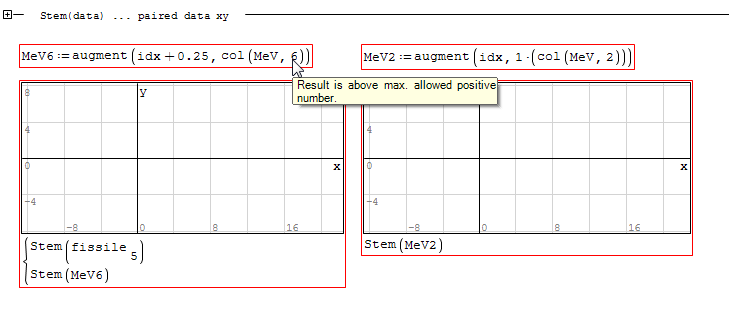

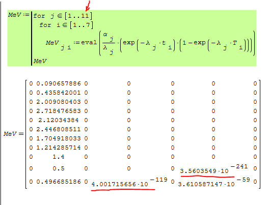

Hello Jean,
Is this what you mean? Checked with version 7019, and plots do not work.
#23 Опубликовано: 15.08.2019 12:01:43
Hello Jean,

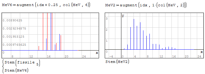

#24 Опубликовано: 15.08.2019 14:04:28
... Is there any red ?
Copy/paste in IrfanView, Resize-Resample to enlarge the ^-
I wish the paper shows some result or graph.

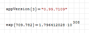

SS 6179 ... exp(709.782)=1.796412028*10^308
SS 7019 ... exp(709.782)= red or something

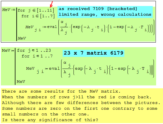

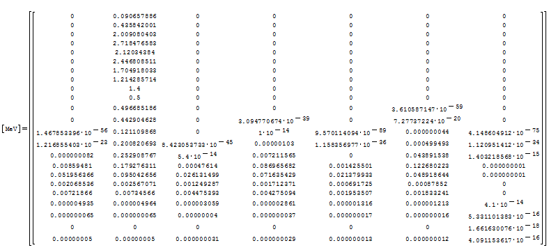

There are some results for the MeV matrix. When the numbers of rows j>11 the red is coming back.
Although there are few differences between the pictures. Some numbers are zero on the first one contrary to some small numbers on the other one.
Is there any significance of this?

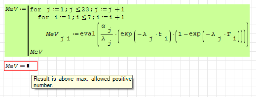

not related with ranges function. even rewriting as for(4)
function, equation gives the same problematic result.
I have downloaded several old versions and found the last
working version is 0.99.6824. After this version there is
none giving the expected result.
#29 Опубликовано: 16.08.2019 10:34:43
Hello Jean,
I just put 11 in the range because any number greater than 11 will produce the famous error "...above max. positive number...".
The only thing I can figure out is that the version [7109] (and some versions before) has some serious problems with float/symbolic calculations.
Therefore I can consider this as a serious bug.

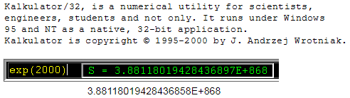

My Kalkulator is older than my Mathcad 8 Pro. [2000]
Does it suggest some profitable code ?

exp(709.782)=1.79641202802057*10^308
That's what it has to be checked first SS 7019

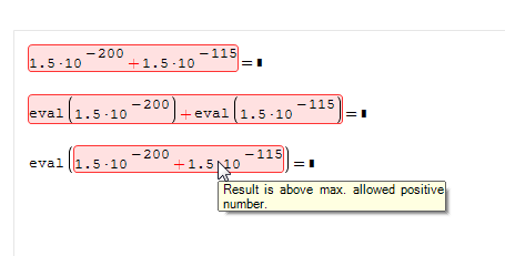

Let me repeat my main point about this error which I believe it is a bug. It is not about exp() function.
Please try in every software you want to calculate this simple addition of two small numbers.
SMath will issue an error (with the rather confusing message) but every other software I tried will not. The result will be either zero or 1.5e-115. That is the point.

#38 Опубликовано: 21.08.2019 13:52:57
You are right Radovan, this should be a bug. I have checked the addition on old versions.
0.99.7016 (and older versions) can calculate the mentioned additon, 0.99.7100 and after doesn't.
Let me clarify something, exp(709.783) is still not calculated on 0.99.6824 too.
But somehow the Project Fission.sm calculations can be done with 0.99.6824.
There is some serious issues over here.

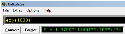

The utmost limit 709.782 except Kalkulator and Casio
from some method switching from exp(x) to some series.
That kind of magnitude has certainly no interest.
Why 7019 is bug ?

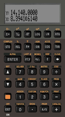

CBG
CBG
The Free42 calculator for Android supports the value of 14,140 for the exp () function
exp (14140) = 8.3941 E+6140
Carlos
