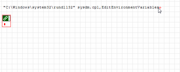

UPDATED
- command-line options
syntax: 'ProcessToStart'[space]Flags
[edit] - Graphical adjustements

#23 Опубликовано: 26.08.2013 14:14:20
UPDATED
Just to complete the early introduced feature
- converter on paste accept command-line strings (input string: "ProcessToStart"[space]Flags)
so when you paste in the placeholder something like:
"C:\Windows\system32\rundll32" sysdm.cpl,EditEnvironmentVariables
this will become:
"'C:\Windows\system32\rundll32' sysdm.cpl,EditEnvironmentVariables"
best regards,
Davide

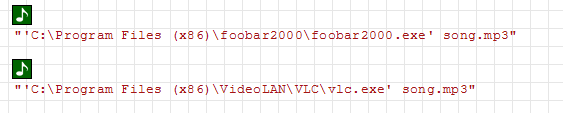

Just found out about this plugin.
Thanks for the work man.
Just a few quick questions,
lets say i wanted to open up a file with a specific program, what would i type into the hyperlink?
for example, lets say i wanted to open up
song.mp3
with the executable
C:\foobar\foobar.exe
#27 Опубликовано: 11.09.2013 15:13:36
1222 сообщений из 2150 понравились пользователям.
song.mp3
with the executable
You might try the approach shown in post23.
Use "'C:\foobar\foobar.exe' song.mp3". It is essential to quote the executable path with ', otherwise windows takes the space as part of the prog name.
#28 Опубликовано: 11.09.2013 17:50:46
Exactly
with foobar, if your song contains some spaces use wildcards (*) instead of spaces (f.e. this doesn't work in vlc; I'll think to another approach or another solution to fix this - maybe a double single quotation to have a double quotation or a context menu dialog...)
regards,
Davide

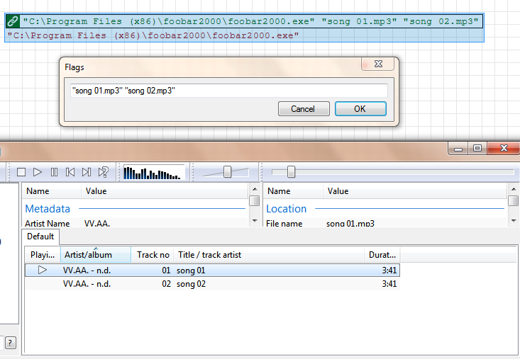

#30 Опубликовано: 06.10.2013 20:09:31
UPDATED
- Flags input moved from the placeholder to a dedicated context menu item.
This solve double quotes issues involving flags and SMath strings.
- PASTE feature works also with the new input way.
(TEMPORARY feature) To update worksheets containing the old syntax ("'process' flags"):
- open the worksheet
- save the worksheet
- close and open again the worksheet
- delete all except the process name from the input placeholder
regards
Davide
IVR 07.10.2013 08:57:00

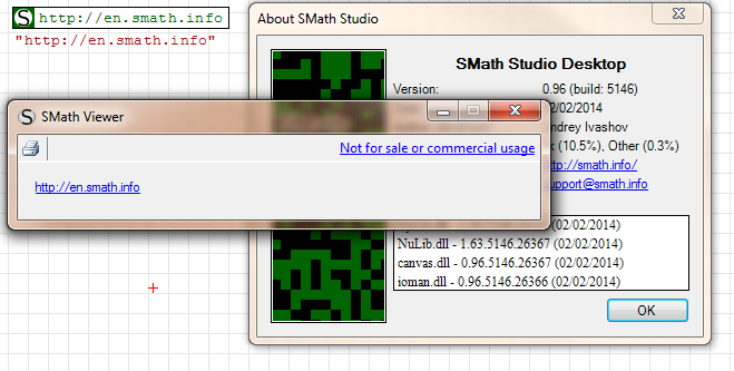

#32 Опубликовано: 02.02.2014 09:31:50
UPDATED
- SMath Studio 0.96.5146 required;
- restored red background when the region is disabled;
- click on resize markers now doesn't trigger the link.

#34 Опубликовано: 04.02.2014 06:48:12
dyleks
dyleks
I am using it with version 0.96.5146 but generation
of executable version (viewer) doesn't work for me.
Is that known issue ?
#35 Опубликовано: 04.02.2014 07:08:28
Hello, I can't reproduce the issue... could you attach a file that doesn't work for you?
#36 Опубликовано: 04.02.2014 08:10:27
dyleks
dyleks
The issue is solved.
After SMath was restarted it works.
Sorry for bothering you.
