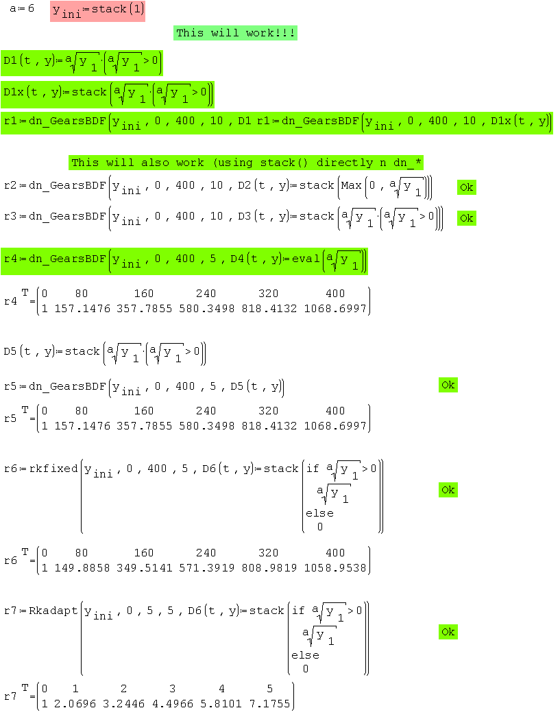

I played around a bit with the examples by Radovan.
My observations:
- using stack() or not is irrelevant in the single first order equation case.
- D and initial condition may be scalar or vector-valued.
- if() and Max() and eval() work, if D is defined inline (in the solver argument list), they do not work, if D is defined outside.
- the different behaviour of Rkadapt is due to poor convergence of the adaptivity algorithm.
- if rkfixed (and possibly the other solvers as well) fails, then you can evaluate the expression using = and get an error
- if rkfixed succeeds, there is no way to evaluate it using = (key is ignored), you have to use assignment instead
if-max-eval.sm (12,95 КиБ) скачан 1699 раз(а).
#42 Опубликовано: 05.08.2013 14:37:42
Updated. Source code refactoring.
The problem here is not the solvers, the problem is in the values ​​of the function parameters.

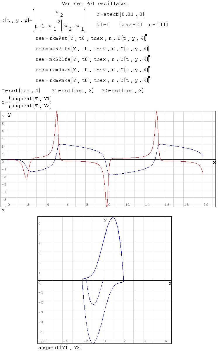

#49 Опубликовано: 13.08.2013 22:51:32
Updated. Added functions from the Intel® Ordinary Differential Equations Solver Library: rkm9st(), mk52lfn(), mk52lfa(), rkm9mkn(), rkm9mka().
mk52lfa() not finished yet.
ODESolvers. Van der Pol oscillator.sm (10 КиБ) скачан 1732 раз(а).
Davide Carpi 14.08.2013 04:20:00, Radovan Omorjan 14.08.2013 03:30:00

#52 Опубликовано: 14.08.2013 05:37:41
Works on x64 systems (at least on my notebook), except for the mk52lfa(Y,t0,tmax,n,D(t,y,4)) (Y not defined)
best regards,
Davide
#53 Опубликовано: 14.08.2013 05:46:46
best regards,
Davide
Thank you, Davide. Unfortunately, this function requires the Jacobian. It must be specified explicitly. Some other functions also require it, but it can be omitted. I'll have to change the number of parameters to a function call.

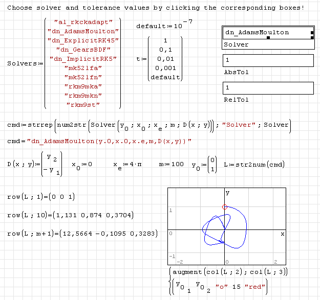

#55 Опубликовано: 14.08.2013 10:42:48
Here is a nice little toy for exploring precision control. Have fun!
Radovan Omorjan 15.08.2013 01:29:00, Вячеслав Мезенцев 14.08.2013 17:15:00

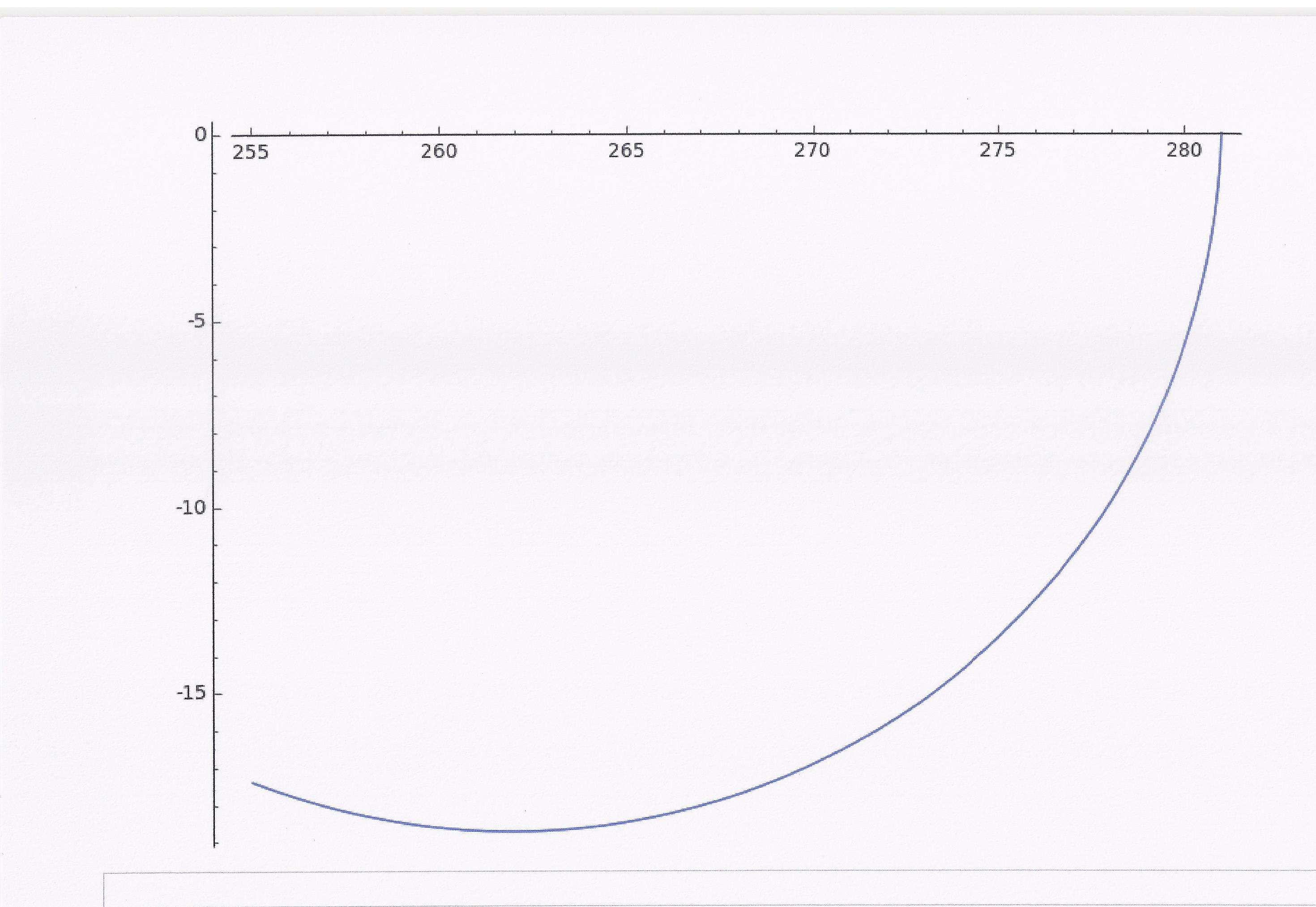

#59 Опубликовано: 15.05.2015 05:36:35
madan26
madan26
I have solved one equation in sage math but not able understand how to solve in smath anybody can guide me on this. below is my equation
exercise1
r = var('r')
PI = pi.n()
rc = 281
rw = 262
Bc = 36/180*PI
F = (r^2-rw^2)*sqrt(rc^2-r^2*sin(Bc)^2)/sqrt((rc^2-rw^2)^2*rc^2*cos(Bc)^2-(r^2-rw^2)^2*(rc^2-r^2*sin(Bc)^2))
F.show()
z = function('z',r)
d = desolve_rk4(diff(z,r)-F,z,ics=[rc,0],end_points=255,step=-0.01)
list_plot(d,plotjoined=True, aspect_ratio=1)
