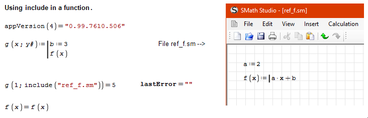

Hi. First, thanks for your work. I think that include it's one of most important tools in SMath for write advanced functions, like ode solvers, in native SMath code, instead of use C# plugins.
It's possible using include in a function body? Please, see the attached. In case that it could be, can also be values in include only local for the caller function, and not to the entire worksheet?
ref_f.sm (2,29 КиБ) скачан 1418 раз(а).
work_with_ref_f.sm (19,44 КиБ) скачан 1393 раз(а).
work_with_ref_f.pdf (102,22 КиБ) скачан 767 раз(а).
Thanks!!!
#128 Опубликовано: 18.11.2020 06:09:21
using "include" as a function parameter can work around the problem!?
Alvaro 18.11.2020 13:36:00
#129 Опубликовано: 18.11.2020 13:35:22
Hi Pompelmo. Absolutely. That' exact what I want. Thanks very much.

I understand the idea of introducing include in some kind of collection, something similar writefile, readfile. But, include is a one time use. In the attached, if I copy/paste include in a new sheet file not found ... same if recall from the f(x) menu and code.
The idea was to use the algos include for other data fitting session.
OK, in that single use include, no problem to add more fitting sessions.
In the attached, we have 3 fitting sessions all happy from single include.

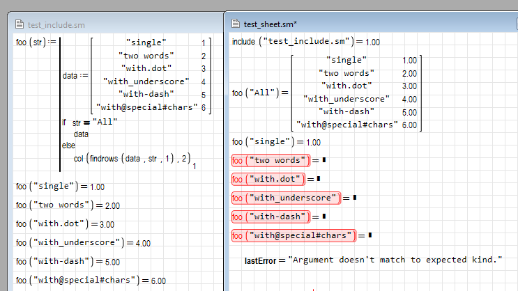

Hi. Thanks for this plugin. I found it very useful in creating a single custom functions file for my team.
I'm encountering errors when I have strings with spaces or any other special characters as arguments. If I call the function within the included file there's no error. Does anyone have an idea on what's causing this?
Thanks.
test_sheet.sm (5,08 КиБ) скачан 1444 раз(а).
test_include.sm (5,18 КиБ) скачан 1433 раз(а).
#138 Опубликовано: 10.12.2021 06:22:01
SMath Studio compatibility
Plugin updated. Please try.
The update solves the problem. Thank you very much uni.
