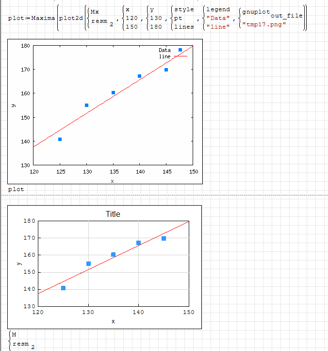

Nothing spectacular, just followed Martin's example from the least squared fit and produced this simple plot after using the problematic function from stats package. It was a bit trial-and-error, and it might be not so elegant-but it works.

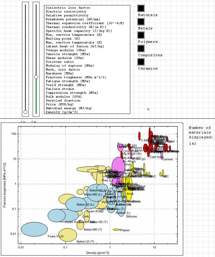

Here is a small program for generation of Ashby-like material property charts. The data has been taken from the online ressources for Buchmayr 2002. Besides the Maxima plugin and it's drawing functions this program also demonstrates the use of varous plugins by Davide (Table, Slider, DataExchange, Checkbutton List)
It would be easy to generate the bubbles in the modeller region. But that has to wait until Andrey finds some time to document how to place text annotations.
Then one might be able to click the bubbles in order to create and place label strings.
EDIT: Due to a checkboxlist bug I had to remove the material chooser. For now you have to switch on and off the materials by setting the corresponding entry in gr.sel to 1 or 0.
Werkstoffdiagramme.zip (48,98 КиБ) скачан 476 раз(а).

#49 Опубликовано: 18.04.2014 06:17:36
Thanks Martin, nice work
CheckBoxList is under development (alpha/not public - in this state it's "naturally" buggy) :d
Best regards,
Davide

Improved version of the Ashby chart generator.
- bubbles are elliptic
- minimal bubble size independent of axes limits

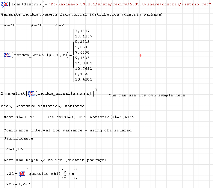

- separate checkboxes for selection of material groups
#51 Опубликовано: 28.05.2014 12:27:03
Here is a modified version of Radovan's distrib-example. Changes were required, because of
- The plugin does not convert Maxima lists to SMath vectors any more,
- distrib functions seem to require float arguments.
Radovan Omorjan 28.05.2014 12:32:00

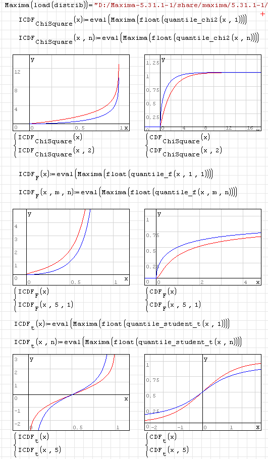

#52 Опубликовано: 29.05.2014 05:21:39

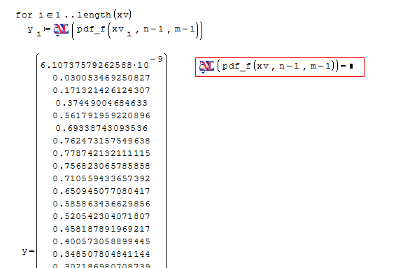

Thank you Martin for correcting the example. Here is another one using F distribution from Maxima distrib package. Statistical plugin by Davide is used as well. There is a nice feature in this plugin of returning two columns when using probability distribution functions (missing quantile functions unfortunately). One more interesting thing is to note about distrib package functions. They will not use vectors as arguments returning vector results - therefore we have to use loops (see the second picture). This is contrary to other Maxima examples where we can avoid loops in Smath
Davide Carpi 29.05.2014 05:25:00
#53 Опубликовано: 29.05.2014 18:09:22
Much like the SMath plugins, many Maxima features are provided by third party packages (wrt the core development team) and there are as many opinions on what a good function interface is as there are contributors.
It is surely possible to re-define the Maxima functions such that they accept matrix arguments and return two-col matrices in that case. If you have a corresponding idea, then you can add the definition to your maxima.xml and try if it works. We can then include this into the plugin distribution.
I added a Maxima based plot to the sheet.
distrib-Maxima_Kr_F.sm (101,96 КиБ) скачан 1390 раз(а).

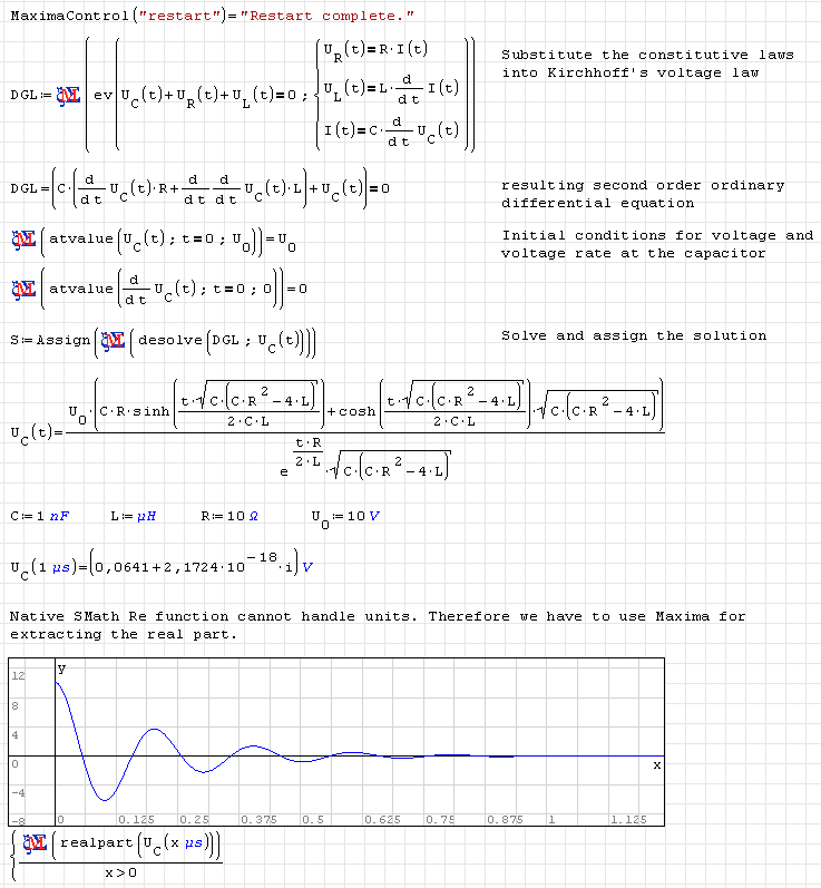

#56 Опубликовано: 05.06.2014 13:29:30

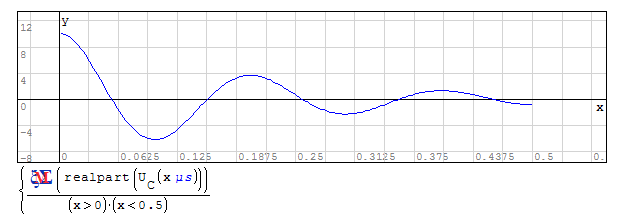

Here is an example (LRC oscillator) for solving differential equations from the Maxima mailing list. The combination of SMath Studio and Maxima has much better and more convenient support for units than native Maxima.
The first version solves the generic system of differential and linear algebraic equations directly. A second version is to follow in the next post.
Example Maxima desolve.sm (12,52 КиБ) скачан 1307 раз(а).
Radovan Omorjan 06.06.2014 01:17:00
#57 Опубликовано: 05.06.2014 13:36:27
And here is a version of the previous example where we reduce the system to a second order ODE using Maxima's ev() function. Due to spurious imaginary parts in the numeric evaluation of the result, we have to use Maxima again for extraction of the real part.

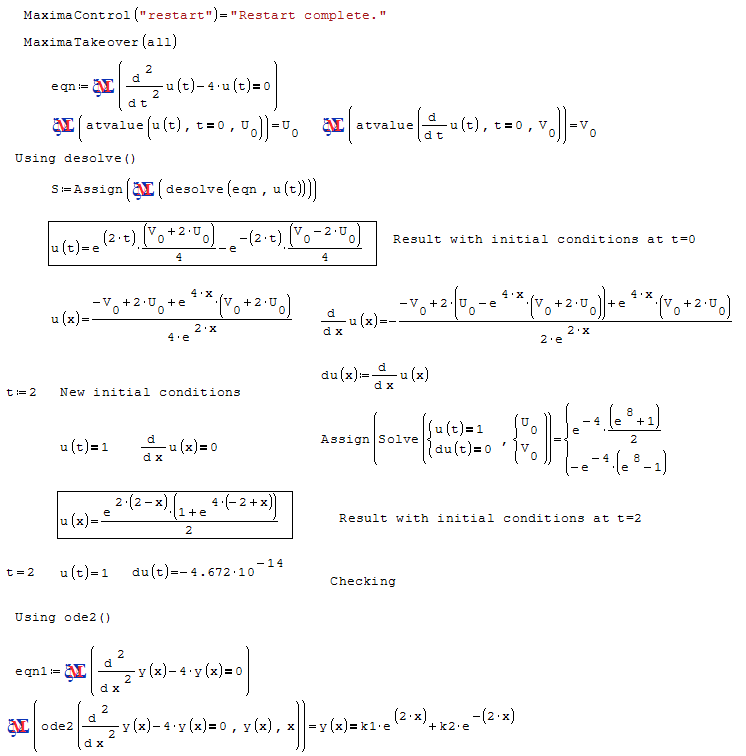

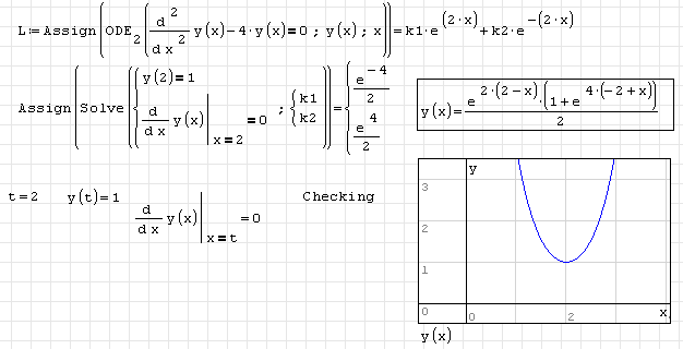

Just testing desolve() based on the example from Maxima by Example. I am not sure that desolve() can solve other than initial conditions for t=0.
Martin Kraska 06.06.2014 09:39:00
#60 Опубликовано: 06.06.2014 09:52:59
Maxima doc says that initial conditions can only be specified for x=0. One might wonder why then t has to be specified in atvalue(), but that function has more uses than just specification of initial conditions.
BTW, you also can use ODE.2, a wrapper for ode2, with preprocessing of the equation switched off.
Also, you can specify the initial conditions in Solve using Davide's at().
