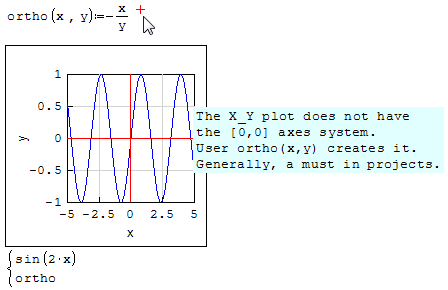

Maybe your work sheet needs be doctored as well as mine.
It happens, correct during the session of construction,
but fails on re-opening PC [little pest].
Solve Diophantine X_Y Plot.sm (25,08 КиБ) скачан 1243 раз(а).

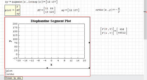

Your file gives me the error of division by zero in the graph.
Carlos

I too get the same error with 99.6611.

In the collected plot, neither f, XY, xy can issue this error message.
Hope not, otherwise X_Y would be all bug.
The module ortho(x,y):= -x/y may be the guilty. Try to remove it.

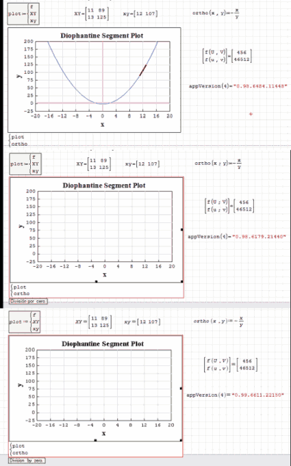

Hello Jean,
your file runs perfectly in the version of Smath Studio "0.98.6484.11448",
and fails in the versions "0.98.6179.21440" and "0.99.6611.22150", the error
is caused by the function "Ortho = -x / y". If this function is removed from
the graph, the error is eliminated, but only Parabola is plotted.

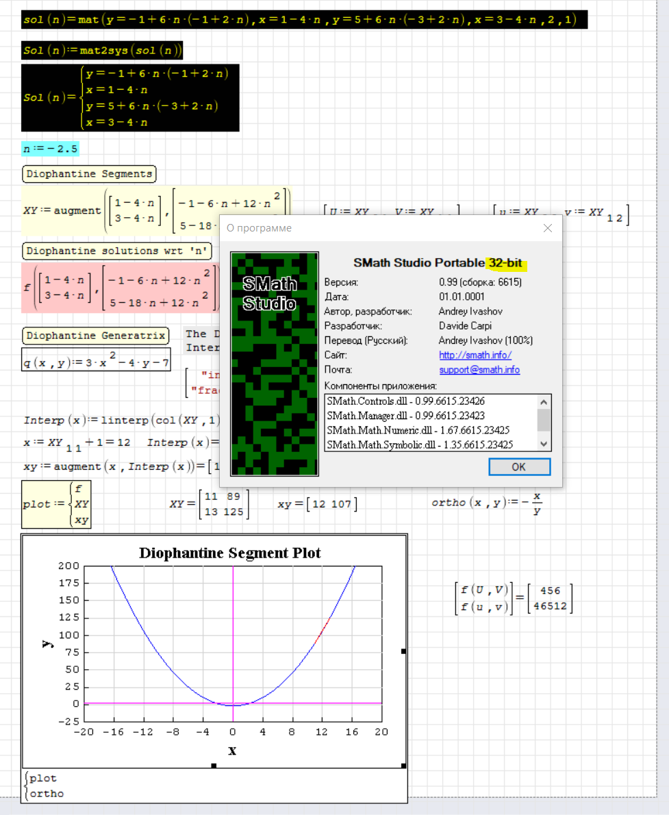

I have checked your worksheet and see question we have here is not about stable/not stable, this is about environment. I have checked different versions of SMath Studio (including 0.98.6484.11448, 0.98.6179.21440, 0.99.6611.22150) - error is shown everywhere.
Then I've tried to open SMath Studio in 32-bit mode and this helped! When it is 32-bit worksheet calculated without errors and graph is shown correctly.
So this is about 32/64 bit and present in all versions of the program.
(build 6615 32 bit = build 6611 64 bit)

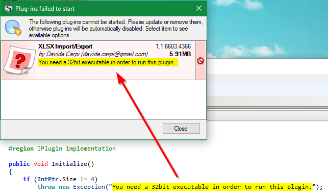

The bitness is also known to be relevant for the function of 32bit mathcad user libraries in the Mathcad EFI plugin. These require SMath Studio running in 32 bit mode. I am not aware of plugins which insist on 64 bit mode, therefore my portable pre-configured distribution is generally set to 32 bit. It is in fact very easy to do using the CorFlags executable posted by uni somewhere in the forum.
I don't know how hard it is to switch or check the setting from inside SMath. My proposal would be to verify the matching bitness in the extension manager and at least warn about conflicts or just do the required adjustments.
However, I am not aware of a particular bitness of worksheets beyond the required bitness of the referenced plugins.
EDIT: From the info dialog it is obvious that the bit mode can be determined from inside SMath.

The bitness issue is typical of p/invoked libraries or external processes, something that smath can't manage automatically (except maybe introducing in the interface a flag that the plugin author can set manually to explicitly declare the plugin incompatible); however the developer can already throw an exception during the initialization to prompt the incompatibility to the user (mathcad efi f.e. has this check but it is suppressed in favor of his internal logger)

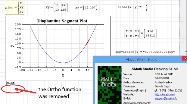

Here the question is:
How is it possible that by removing the Ortho function
from the graph, the file will work correctly?
What does the definition of the function
Ortho (x, y) = - x / y have to do with the version at 32 to 64 bit?

Good question. I see that you can get rid of the issue if you change the limits of the y axis. I think that the issue might be in some double value rounded differently in 64bit vs 32 bit... also the plugin is not based on external libraries... must be debugged
