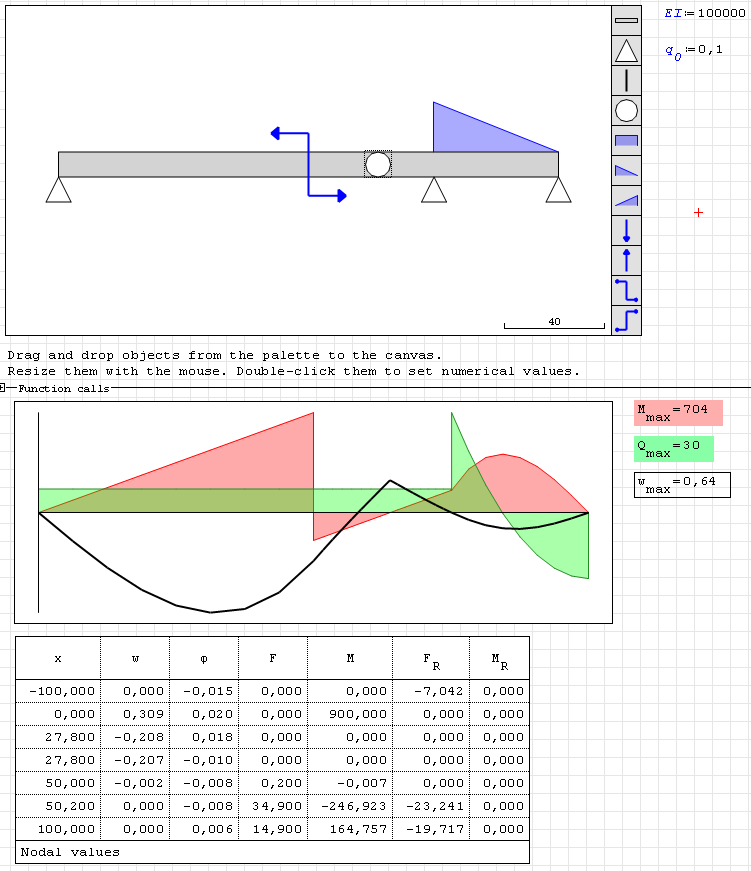

Davide: here comes the same in green :-)
Ioan: Doubleclick on any object on the canvas gives you numeric control. This is handy for forces (x co-ordinate and lenght are relevant) and supports. For beams and distributed loads, the endpoints have to be specified indirectly via x co-ordinate of the midpoint and by width.
Another way to apply numeric control is to edit the values of N between preprocessing and solving.
As to the hinges: They can be done by having 2 nodes at the same position and linking their vertical displacement by an additional equation (zero lenght beam element with zero bending stiffness)
I thought of representing this by a black circle. In the preprocessor, this requires quite some added lines, in the FEA function I see no problems.
Another DOF per node is required only if you want longitudinal displacements and/or arbitrary beam orientation, which currently is beyond my ambitions and also beyond what can be done with the modeller region. I see no way to draw an oblique line except to provide some more symbols and scale them accordingly. But then-how to make oblique triangles and rectangles...
Andrey, do you have an idea, how I can avoid having separate force symbols for up and down directions or left and right moments or left and right triangular distributed loads? Is there a way to flip the symbols interactively?
If not, I would mess up the template palette (at least four more symbols are needed: hinge, up force, left and right moment).
I experience strange snap to object behaviour in the modeller region. If I drag a corner, then sometimes the opposite corner is not fixed, making it nearly impossible to create a triangular load with the same extension as the underlying beam (which should be trivial with normal snap behaviour).

Update:
- everything provided as callable functions with description strings
- Solver output modified for more flexible postprocessing
- hinge element implemented (using an element with zero bending stiffness and a penalty for coupling the displacements)
beam1.sm (121,77 КиБ) скачан 1317 раз(а).

One more update:
- up and down forces
- left and right moments
- table of nodal results (including support reactions)
- sign of shear and moment line changed (positive direction for shear and moment is upwards in the diagram)
The stuff is uploaded as example. It can be opened in the cloud version, you won't see, however, the table of nodal results because it uses the table region plugin by Davide.

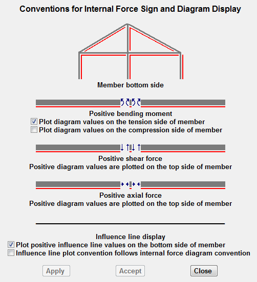

There'a an easy way to setup the diagrams conventions? Usually I use the shear as in your last example and the positive moments on the tension side...
i.e. the Signs conventions panel of Ftool
Martin Kraska 05.10.2014 14:14:00
#49 Опубликовано: 05.10.2014 14:10:44
Setting the signs is easy. Have a look at the function BeamPost().
The convention used in the final example is that which I use for teaching.
External forces correspond to steps in shear and distributed loads change the shear curve in the direction they are sketched.
The shear line gives the slope of the moment line. This facilitates easy sketching of the lines without non-obvious sign conventions.
the drawback is that the positive direction in M and Q diagrams is opposite to the positive direction for external loads and displacement.

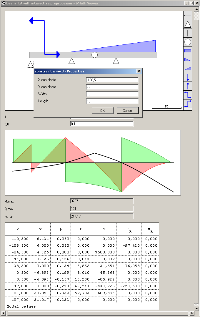

Example updated.
- Non-zero displacement constraints (y position of triangles is evaluated)
- Solver crashes due to non-invertible systems avoided by connecting orphan nodes with low
stiffness beams
- Instructions added
The code should be fairly stable now (impossible to crash by whatever senseless model layout). Please report any issue.

#51 Опубликовано: 06.10.2014 05:43:06
Don't ask me why, but now BeamFEA.sm runs in the viewer.
I uploaded it as application to the gallery (table of nodal values is missing, because the exe is compiled on server side without external plugins.
If you want an executable with table, then save the example as exe and you are done.
