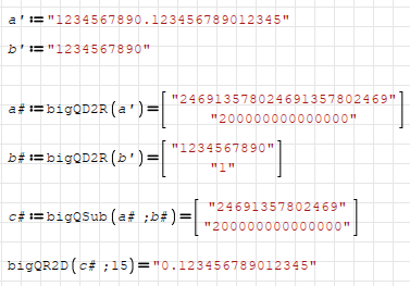

WroteIf you define a variable out to 15 decimal places, the calculations will carry that precision through.
Actually you can't define a variable to 15 decimal places.
All variables shall be 16 numbers long, including integer+decimal parts.
If integer part is 10 numbers, decimal part shall have 6 precision.
If integer has 9 number length decimals shall be 7, etc.
I don't want to promote myself by saying it.
But this is why I have written big rational plugin.

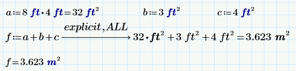

Hey Andrey, I'm still very interested in this feature, and I think a lot of people are also.
MathCAD Prime 10.0 has this:
The only problem is MathCAD won't let you hide the "explicit, ALL" text on the formula. It really makes the calculations look crowded and messy.
It would be amazing if SMath could do something similar, but make it better.
Is it a matter of funding?
Let me know please.
