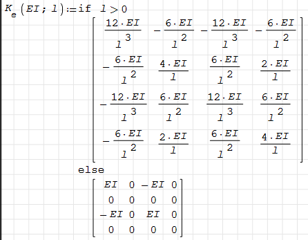

In the 1D beam analysis application BeamFEA, I use hinge elements for rotary dof release (to insert a hinge in the beam). They connect coincident nodes of adjacent beam elements.
In the 1D case, the element matrix is just parametrized by the stiffness EI and the length l. The dofs are w1, phi1, w2, phi2. A hinge element is generated if l=0. Then the EI value is taken als spring stiffness between the w dofs of the nodes. This means that equal w for both nodes is not enforced by reduction of the system but by a penalty term.

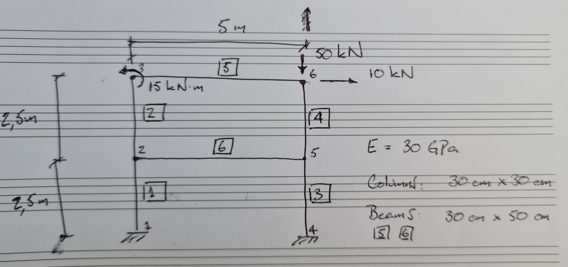

WroteI verified the results in the attached file with some 2D structural analysis software and it appears to be correct correct. Take a look and let me know.
I made some mistakes creating the stiffness matrices for rigid-hinged and hinged-rigid. In my post I edited the image. What was wrong? Well, as it was new to me this stiffness factor of 6 for the rotation around the hinge, I tested and found that it was non-sense, because the adjacent member rotating would not introduce displacements in the hinged element. (Further considerations like friction (end-moment) transmitted through the hinge could be studied, if relevant).
For now I have made tests with this simple model of 6 members. Beam 6 was tested for rigid-rigid, rigid-hinged, hinged-rigid, and hinged-hinged conditions. Comparing with FTOOL (recommended! very simple and useful tool) I all those 4 cases, I've found the same results for the x, y displacements and z rotations with 4 significant digits each (probably more but didn't look at).
Please comment if you test more complex models and loads.

Hi wb.c,
Attached the corrected worksheet. I modified three things:
1. Connectivity for the three rigid-hinged bars. They must be coherent with the elementary matrix: start node is rigid and the end node is hinged.
2. Rotation value must be assigned as a constraint, otherwise you will have a singular Kr matrix. (there is a previous comment that I did on this post)
3. Cosinus formula should be avoided for angle calculations, as cos(alpha)=cos(-alpha), I think that the best way is to use xy2pol. (For example, for the vertical bar, if you change the node order, you will obtain 90 deg as well (instead of the correct value of -90 deg with xy2pol)).
I attached a comparison with a model made in FTOOL to validate the results (different than yours, perhaps because the condition of bars 1, 2, 3 is hinged-hinged).
Regards!

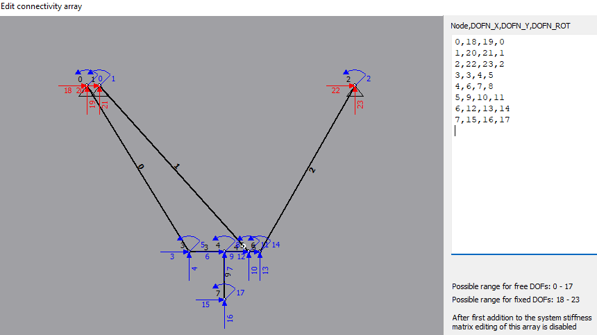

Alvaro,
Thanks for taking a look. I think we should be able to accommodate a hinged-hinged case through the means of a (pinned support)-fixed end--hinged end.
I'm using a program called LinPro 2.7.5, it is a free static and dynamic frame analysis program. https://www.thestructuralengineer.info/software/linpro-275
It handles this case quite well.
It allows you to implement a Study Mode, which shows you the step by step process the program is taking to solve the system.
A couple of notes regarding the program as apposed to what I've seen in other places:
-The modified local stiffness matrix for various member end release conditions seems to be different from what I found in my text book (Matrix Methods for Advanced Structural Analysis - Papadrakakis & Sapountzakis)
For example: Where you might expect to have 3EI/L^3, it seems to have 36EI/L^3, so I'm not sure what exactly they are doing to obtain the modified local stiffness matrix
-The program also always restricts the "fixed" constraints to the end of the DOF numbering.
So what I am trying to do is replicate the frame analysis by FEM, but for this specific case and then be able to apply a load at 360-degrees in order to find the worst case for each "strut".
This can be done without FEM, with just trig and statics, but only up to a certain number of unknowns. So hence the FEM method.

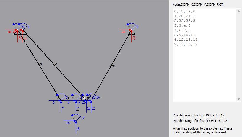

For the sake of simplicity, I eliminated some of the automated vector assemblies, as I didn't want to spend too much time trying to figure a good way to work with the DOFs as they are shown in LinPro.
Assembly Vector - Manual
Elimination Vector - Manual
Force Vector (global) - Manual
They start with 0, SMath with 1, so keep that in mind.
What they do is restrict the fixed DOFs to the end of the DOF numbering.
Now, my K (global) matches the result from LinPro exactly.
There was some interesting things that had to be done to make that happen:
As Jean has pointed out in the past, the order of matrix multiplication has varied results.
It seems that for this configuration:
![2023-03-08 17_23_58-SMath Solver 1.0.8348 - [New Frame FEM Example.sm_].png](/ru-RU/files/Download/nhTBqC/2023-03-08-17_23_58-SMath-Solver-1.0.8348---[New-Frame-FEM-Example.sm_].png)
I could not get the global k matrix to match the results in LinPro.
I ended up arranging it like this:
![2023-03-08 17_24_09-SMath Solver 1.0.8348 - [New Frame FEM Example - Updated.sm_].png](/ru-RU/files/Download/zy4hgV/2023-03-08-17_24_09-SMath-Solver-1.0.8348---[New-Frame-FEM-Example---Updated.sm_].png)
And it worked.
I also removed all units for now, because as it seems, the inverse operation of a matrix requires numeric evaluation, and with units, I get a "units don't match" error, and you can't evaluate the inverse symbolically for some reason (That's a whole different topic for another day...).
In any case, After getting the right complete stiffness matrix K, it seems that things go south. Solving for the reduced displacements vector is way off.
It seems that LinPro produces an updated forces vector after solving "the system of equations" that includes the reactions at the fixed DOFs along with the forces applied.
It makes me wonder if perhaps there is something off in the sequence we have in the SMath sheet.
After we assemble the complete stiffness matrix K, we obtain a reduced K, Kr that eliminates the fixed DOF (in this case, the last 6 DOF, 19-24).
Then we use that Kr along with a reduced F, Fr, to solve for reduced deflections, Qr.
Is all this right?
Maybe a set fresh of eyes can find the problem here:
New Frame FEM Example - Updated.sm (129,74 КиБ) скачан 1264 раз(а).

Hi wb.c,
There was an error in your connectivity table for the last bar. Also, k_prime = L'*k*L (and not L*k*L' ) must be used to retrieve q_prime =L*q. I corrected your transformation matrix L (I shared a good book on this topic, you can take a look at chapter 5 to see the L matrix). You described the correct procedure at the end of your comment.
New Frame FEM Example - v2 (LinPro validation).sm (129,22 КиБ) скачан 1406 раз(а).

The issue now is that this loop takes some time. Currently about 22-sec.
I would like to speed things up as much as possible.
I already stripped down the the original sheet and eliminated any unnecessary calculations, but the real time consumer here is obviously the loop containing 360 steps.
Originally I thought that I could only evaluate 180 degrees and that the other 180 would just be opposite, but the results are not quite symmetrical, so 360 it is...
In the loop, I am only calculating member forces for the first 3 members, but before that, displacements must be calculated for the whole system.
The loop is not storing large vectors, in fact the vector being stored only contains 3 smaller vectors, each of length 3, for each of the struts in question.
The stiffness matrix is only assembled once, and the loop is really only for solving for Q as the applied force changes and then the solving for the member forces.
The loop then evaluates if the new value is the biggest so far and if it is, it will save it. if not, it keep the previous value.
Any ideas on how to speed up the loop?
Maybe there is a way to isolate the FEM method to only the three members of interest? So that Q is smaller?
Maybe there is a better way to get the worst case for each strut out of the loop?
Thanks!

You're welcome! So, you can do a few things:
* Kr is unique, you can invert it only once outside the loop.
* When calculating Qr, avoid multiplying by zero in the rows of EFr.
These two things reduce computation time to ~ 1.4 sec in my machine.
FEM Concept v1.0.sm (109,55 КиБ) скачан 1294 раз(а).
