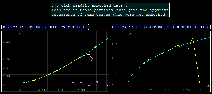

are data provided by the producers of materials or devices whose characteristics are not determined by analytical mathematical formulas, but only by measurements in the laboratories of the respective manufacturers.
That what I'm trying to explain: collected data are not true, they are just data.
They carry the noise from digitizing the measurements, hysteresis ... and manipulations
from the Lab(s). You can only interpolate pure or considered pure data.
What's the point to interpolate between noisy data ?
Matlab has "Spline smooth" [gadget] => That's why they never did carbon 12 alpha.
Please attach a vector of your data, just to check and keep going ahead, and
orient towards some interpolation method [there are quite a lot !].
At the point you are, the sole methods that will clean and interpolate are
polynomials methods. Not necessarily successful for any kind of profile.
Isn't an objective to model the data set by a function ?
Waiting for a vector of data ...

Three tings here: from very quick
1. a polynomial fit
2. Grow2 model
3. power model
One way or another, you have to do for each column
then populate for more data points, compose the matrix,
from the smmoothed matrices, proceed like before to interpolate
within the matrices ...
Not a big job for me, please do not hesitate: YES/NO

Hello Nicolas,
This is as far as can do from your data. They aren't so nicely collected
as you pretended. Some models will do as well but can fit "Genfit" Smath.
Please: comment ... Jean

There are many ways to approach engineering. There are researchers in engineering issues, who usually do projects that have input data, vectors or data matrix results directly from lab measurements. These data are smoothed even by the project that these researchers accomplish and are then collected and edited in special books, called engineering design guidelines. There are then design engineers who use those design guidelines with readily smoothed data. Their project input data will then be processed by interpolation from the existing tables in these design guidelines. There are then applicant engineers, who read the projects made by designers and translate them into engineering products in the process of technological processing. The list can continue. I did not work in research, but I'm part of the second category. So let's clear the problem. All the arrays in my examples represent the magnetization curves of some magnetic materials, with certain preset parameters. The graphs provided by you are not relevant, as I have used interpolation, linear interpolation. At the same time, to simplify the vectors and data matrix used for interpolation, they were introduced into the project as discrete values ​​having intervals (where the curve has a more linear shape) where the data is more distant from each other than in the curvilinear portions. Cumulating the effects of how matrix values ​​are entered with the fact that I used a linear interpolation rather than a non-linear (cubic, logarithmic, etc.) resulted in those portions you presented that give the apparent appearance of some curves that were not smoothed. I hope the problem is understood and we will not discuss in the future the issue.

The project is still in limbo, as long as you won't provide raw data from the Lab.
#28 Опубликовано: 06.12.2017 09:37:55
Spline2XV6 is world top for processing raw data.
The public version is freeware, somehow not as
powerful as the Mathcad coded version.
