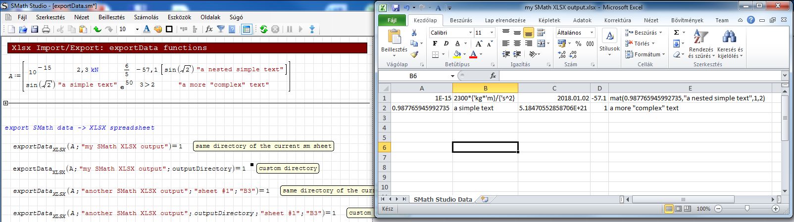

I've tried the examples from the plugin's documentation (https://en.smath.info/forum/yaf_postst1860_Xlsx-Import-Export-plugin.aspx).
Here is a picture (this time I modified '4/5' to '6/5', you can see that this value imported to Excel as '2018.01.02' in our date format 'yyyy.mm.dd'):
Показать спойлер
Other numerical values, f.e. '-57,1' and 'sin(2^(1/2)) imported to Excel as string, so we can't do mathematical operations with these values.
Peter Kaderasz

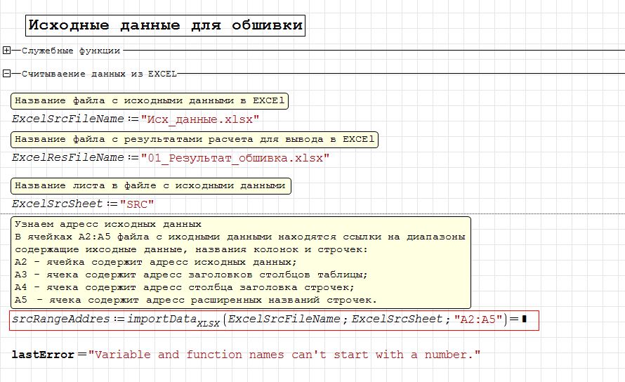

Hello, stopped working import from xlsx file.
lastError = " Variable and function names can't start with a number. File attached
test.sm (7,14 КиБ) скачан 1414 раз(а).
