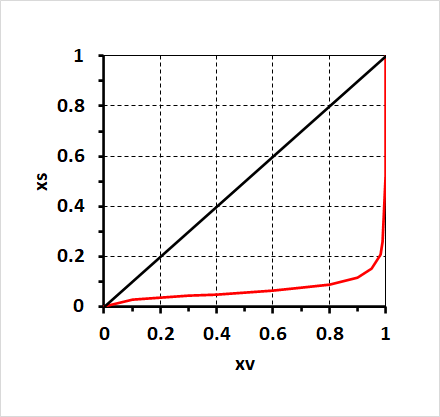

WroteRed line looks good.
It is in line with the expected response of the system.
Red line plot may be integrated providing a model fit is given.
Attach your data set, I will attempt a model.
Cheers ... Jean.

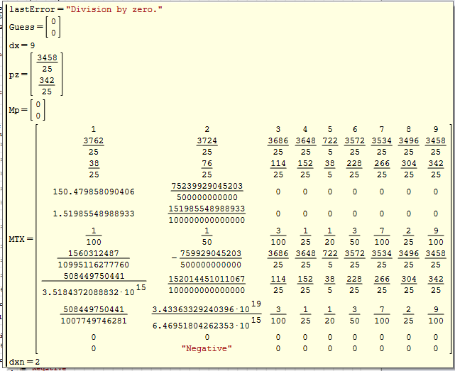

I kept debugging the program. I found a few silly errors.
Hovering the mouse on the program shows the matrix.
The number of loop is reduced to 9 for troubleshooting.
But it's neither displayed outside of the program nor saved in a file.
Is there a way to fix that ?

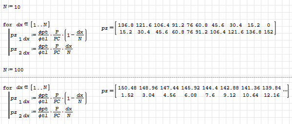

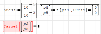

Hi Peter. You still haven't solved the problem that f doesn't find any root for the initial conditions you propose, so the 3rd and 4th rows are zero. In addition, the way in which you build the range for the values of pz(1) and pz(2) does not seem adequate, since its limits depend on N, and it should not be like that (only the intermediate points should depend on N, not both ends of the interval). To save the data to a file, "execute" the command outside of the loop, ie, set exportData(...) = ... at the worksheet level, and not in the loop. Finally, the use of try ... on error is not particularly useful for numerical computation problems, and is actually a convenient and quick way of avoiding actual error handling, as well as being a lousy recommendation for this particular case.
Other problems would also be that you use some subscripts that are units (in blue) or that to graph you must use a double index on the MTX matrix, that is, something like augment(transpose(row(MTX,4)),transpose(row( MTX,5))), but the fundamental thing is that you establish the domain on which you want to calculate and then what are your seed or guess values. Since I do not know the thermodynamics that you are applying in this new version, I am not in a position to recommend any.

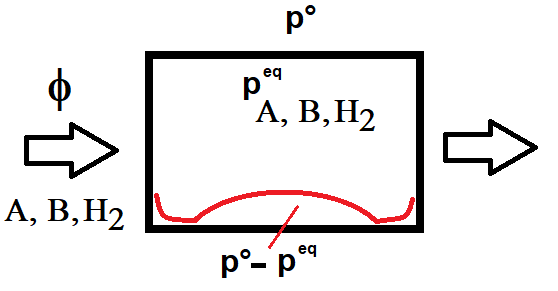

Finally a sketch of the chemical vapor deposition (CVD) reactor and notation.
It's a continuous flow reactor.
But with a 0D approach, the "instantaneous" partial pressures are only considered.
p° (noted pz) are virtual partial pressure based on the flows.
peq is the partial pressure at equilibrium
(pz-peq) give the amount of solid deposited. It's the supersaturation.
It's the same physics for salt and sugar.
If amounts below solubility are introduced, no solid is grown.
The worksheet attempts to calculate the "solubility" of components A and B in order to estimate the composition of the solid.
In this system, the elements are coupled (interaction parameter omega).
