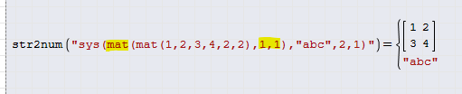

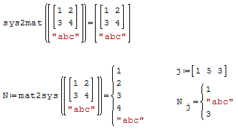

The function mat2sys.1 affects also the inner matrix, if evaluated numerically AND if this inner matrix contains only element.
Is that really the intended behaviour?
I wanted to build my own mat2sys.1 using num2str, ... replace mat with sys... str2num
Looks like str2num is the "culprit", at least in my own function (only while evaluating numerically).
Maybe the better question is: Is this behaviour of str2num intended?

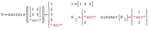

The behaviour is driven by the evaluation of the outer sys(); on numerical evaluation, the "first level" of 1x1 matrices is suppressed.
I'm not sure if it is really intended, but it might be part of the special behaviours of sys() (have to check the code/ask Andrey).

By now I think it's the general behaviour (intended or not), that 1×1 matrices are evaluated to its element (numeric).
That's why I use Gettype() to check if an element was found.

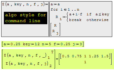

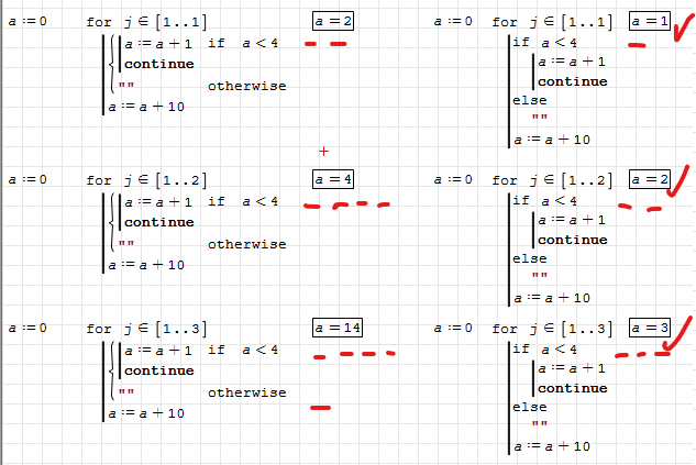

Found a bug in cases in combination with for loops and continue:
Two identical loops.
If if(,,) is used, continue causes the rest to be skipped (as expected).
If cases(,,) is used, continue has no effect
appVersion(4)="0.99.7822.147"

#130 Опубликовано: 15.06.2021 03:19:03
Confirmed, with a strange behavior.
Reversing the cases makes it correct.
#131 Опубликовано: 15.06.2021 03:46:04
At first glance I'm not sure about the cause, I'll check it.
However looking at the screenshot I have to point out once again that in general you shouldn't put definitions inside cases().
Unlike if(), when a condition or a case fails instead of throwing an error the whole function is returned like if doesn't exists. The consequence is that every argument is exposed and preprocessed, with potential unwanted behaviors respect to the expected logic. This is on the edge of SMath possibilities, but is what makes possible to use cases() whereas if() usually fails.

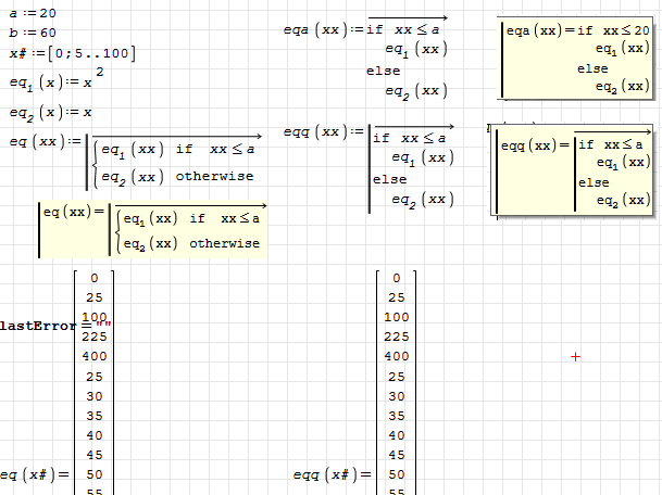

cases() refuse to be vectorized if it is a function.

Sometimes a line at the right place helps a lot.
And hovering the mouse over an expression helps finding the glitch.
Oscar Campo 29.08.2025 10:03:24
#137 Опубликовано: 19.07.2021 18:02:45
Hah, I get it. Mysterious (but necessary according to this) line again.
Even though I use smath several years, I still forgot some of its tricks.
No need to hover the mouse, lasterror() has the same behavior.

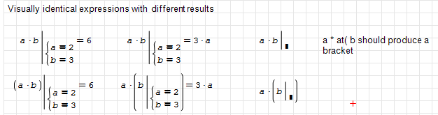

#140 Опубликовано: 11.09.2025 09:51:54
I think that we would need more brackets here in order to make the scope of the at() or the corresponding operator function visible.
