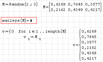

#23 Опубликовано: 17.02.2013 07:40:28
The mat2sys function seems to be limited to column matrices. This might be a feature rather than a bug. In the first case I would recommend to be more specific in the doc string ("Converts column matrices (vectors) to systems" ). Alternatively, the linear indexing feature could be used to flatten the matrix.

#24 Опубликовано: 17.02.2013 14:45:16
Hi Martin
Yes, actually mat2sys function is limited to column matrices (the function brutally changes "sys(" to "mat(", without checks).
An improvement will be available ASAP.

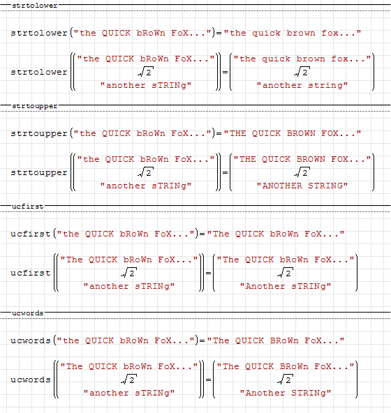

#26 Опубликовано: 15.03.2013 07:05:31
PLUGIN UPDATED
  • added new texts functions:
    • strtolower(1): converts all characters in a string to lowercase;
    • strtoupper(1): converts all characters in a string to uppercase;
    • ucfirst(1): converts the first characters in a string to uppercase;
    • ucwords(1): converts the first characters of each word in a string to uppercase;
    all functions works both with texts or texts nested in arrays/systems;
  • added norme(): unofficial patch of SMath Studio norme() function (BUG shown here);
  • sys2mat(): fixed unexpected influence on input arguments.
Plugin's Sources are moved to the SVN repository (I have added a link in the first post)

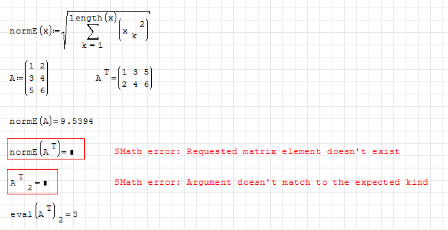

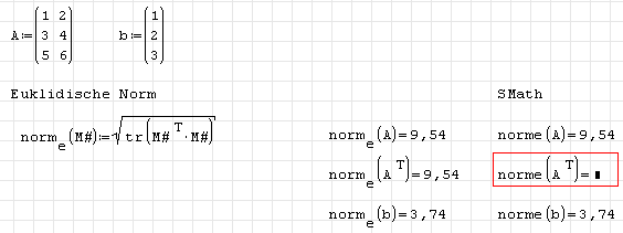

#27 Опубликовано: 16.03.2013 15:59:58
Hi Davide,
thanks for the update. I added the functions to the function reference in the handbook and also added a section on string functions.
The norme replacement is highly welcome. I just had a small problem, see attachment.
Just in case you are looking for distraction from real stuff like unit and systems proof solvers:
I'd vote for unit-proof versions of int(), Re() and Im() and arg().
Martin
#28 Опубликовано: 16.03.2013 16:17:55
Thank you Martin;
the issue is related with some SMath bug involving transpose and the linear indexing feature ... Tomorrow I'll look in the bug section to see if it has already been reported and I'll update the plugin with your formula

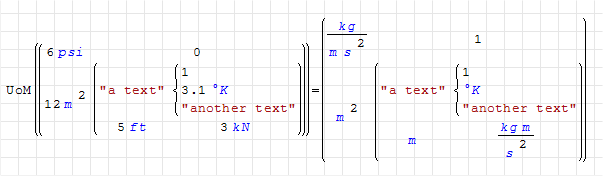

#33 Опубликовано: 23.04.2013 04:31:11
PLUGIN UPDATED
- fixed norme issue with 1x1 matrices
- UoM now get the units element-by-element from any matrix/system (nested or not)
best regards,
w3b5urf3r

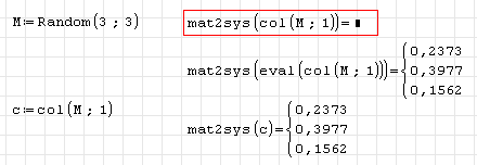

#36 Опубликовано: 27.12.2013 09:29:52
mat2sys requires the argument to be literal matrices. Matrix-valued expressions need to be evaluated first either by assigning them to a variable or by wrapping them in eval(). A similar issue has been reported for sys2mat and has been solved.
I propose to transfer the solution to mat2sys.
Davide Carpi 27.12.2013 20:24:00

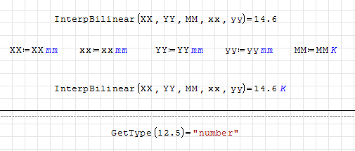

#37 Опубликовано: 01.03.2014 12:12:08
UPDATED
- new function: InterpBilinear()
- new function: GetType()
- mat2sys() improvements for 1x1 matrices
(examples attached in the first post)

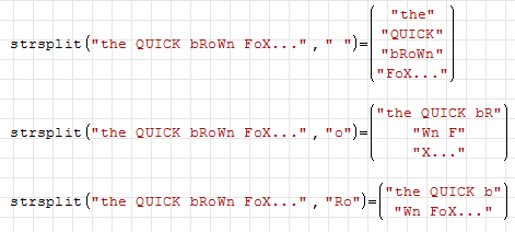

#38 Опубликовано: 22.06.2014 18:42:25
PLUGIN UPDATED
- added strsplit("string","delimiter" )

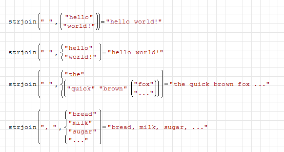

Thank you Viacheslav
Done: added strjoin(2)
Best regards,
Davide
