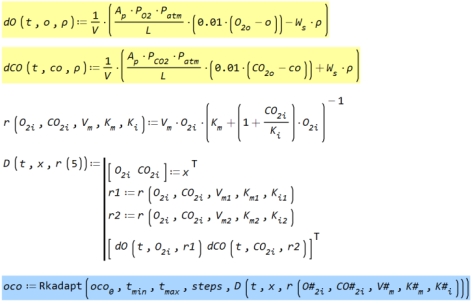

It is possible to solve the system in this way, i.e. integrating each equation separately. But here you need to be very careful.
Hi Viacheslav. Please, explain me with more details about what do you do. I have two questions:
1. Original equations are decupled? Sorry, I don't check that, I ask it because I assume you see this problem in depth and it's easy for you answer this.
2. Is your setup general for solve an ode with a large interval of integration? This is, I know that if the domain for an ode is too large, numerical methods can be implemented "by parts", with small portions of it, but actually never use that in the practice, or remember practical examples of it.
No. I showed the same method, only written differently. For this example both algorithms do almost the same thing.
Yes, you can split a large interval into small portions. The solvers themselves do this. Usually inside the solver there is a loop in which a so-called step-function is called for each portion. This step-function can also split the portion into small parts depending on the complexity or accuracy of the method.
I didn’t point out correctly that it can be integrated separately. I meant that you can split the vector of derivatives D(t,x) into separate parts and integrate each element separately. Since the equations are dependent on each other, then this should be done as I showed.
I did this to make it easier to add elements to the vector of derivatives. Instead of one huge program block, you get many small expressions. This may not always be done, but if the derivatives are smooth over a given interval, then you can even use Euler's method.
I just took the inner for-loop of the solver out and limited the solution to two points (one step). That's all.

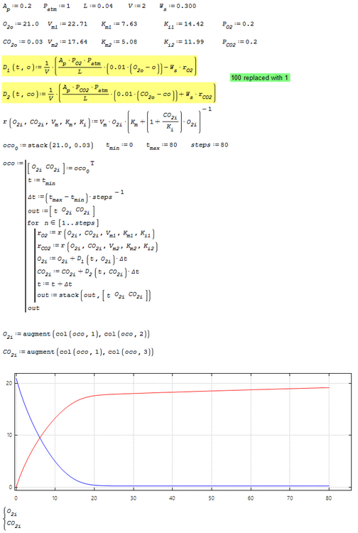

Hi. Thanks Viacheslav for your answer. In the attached, the usual setup for the system of two equations with two unknowns, showing that uni's solution it's the same than the given by Rkadapt. I also can setup a good solution for a 4x4 ode system, but the r's coeffs must to be recalculated before the concentration of O & CO. If not we get a nonsense solution, and guess that this issue is why it's hard to setup a system with more variables, as efus comment that is required. So probably he must to study in which order the updates must to be evaluated for the physical situation.
But what's more impressive to me, it's the Viacheslav intuition for the magistral setup that he do for solve the problem with a runge kutta method with ... one as the step!. Ok, he's the author of the solver plugin, maybe he know what it's talking about.

francesco88

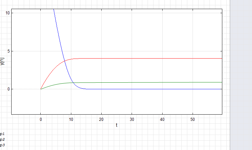

... The solvers also support optional parameters after t and x. You can enter both variables r1 and r2: D( t,x,r1,r2 ). This will make the calculation of derivative values clearer.
I did not know this feature of your plugin. Here, in case that this setup it's ok, it fails, I guess for the order in the updates too.

The ancestor of all these solvers is Euler [Fortran 1970], print stars instead of line.
Your two system DE's can you make them Euler style ?

To be honest, really I don't know if is possible, I can try and we will see what happens.
The problem with these 5 ODE is that they aren't really stable and a lot of strange things happen if the order of resolution isn't correct.
For sure isn't the best-case scenario to face for someone like me, that has basically zero experience with software/numerical methods.
Now I'm sure that in R someone was able to implement and validate it...but really I would like to avoid it for the moment
I will spend this week working on all your advice and trying various approaches, in a way or another some sort of result will come!
This was mentioned here.
Modeling respiration-transpiration in a modified atmosphere packaging system containing blueberry 3 (uni).sm (18,72 КиБ) скачан 1083 раз(а).
Modeling respiration-transpiration in a modified atmosphere packaging system containing blueberry 3 (uni).pdf (79,39 КиБ) скачан 591 раз(а).
Modeling respiration-transpiration in a modified atmosphere packaging system containing blueberry 4 (uni).sm (18,56 КиБ) скачан 1126 раз(а).
Modeling respiration-transpiration in a modified atmosphere packaging system containing blueberry 4 (uni).pdf (77,83 КиБ) скачан 611 раз(а).
This is an optional feature. Everything works without explicitly specifying variables, but this is not always clear.

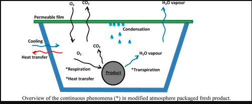

Thanks efus for this drawing describing the physical situation.
:d Ah google come in my help for the pictures, but yes, it describes exactly what happened in the package.

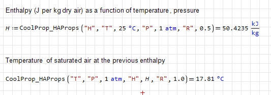

Hi efus. Maybe you could be interested in the coolprop plugin.
Help for humid air: http://www.coolprop.org/fluid_properties/HumidAir.html
Collprop for SMath: https://en.smath.com/forum/yaf_postst7398_CoolProp-Wrapper.aspx
Also, I see your loda implementation, it's ok, and I don't know if the fact that you redefine the parameter "y" in the body of D() have any implication, but you must to know that in SMath if you pass parameters in that way "things happens":
The plugin is for sure interesting! I have intention in the future to face some problem related to respiration with a pure thermodynamic approach, so for sure it will be handy!
