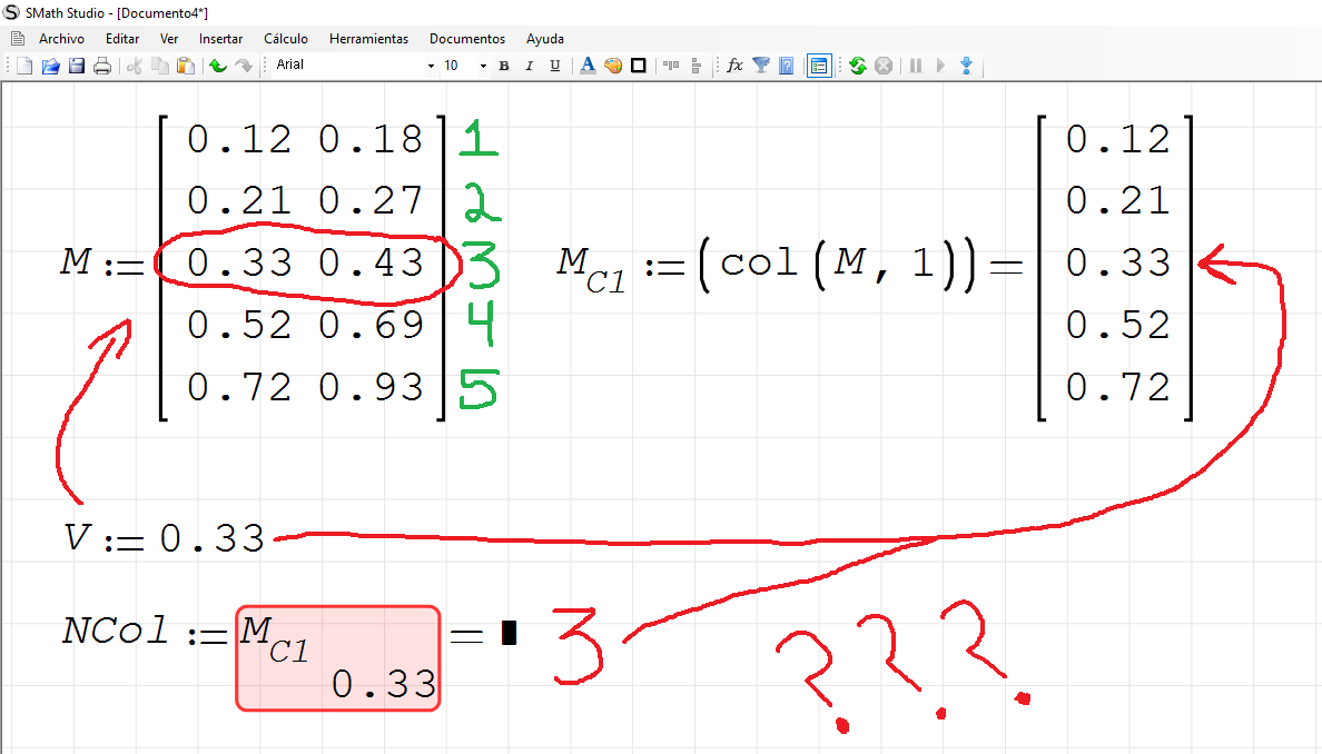

Hi guys
Do you know how to get the number of a row in an array?
ie I have a 5 * 2 array, I want to know what is the number of a particular row
¿Cómo se obtiene el número de una fila, de una matriz?
How do you get the number of a row, of a matrix?
I do not speak English, I hope you can understand me with the following image
#2 Posted: 3/27/2021 12:33:17 AM
NDTM Amarasekera
NDTM Amarasekera
130 likes in 352 posts.

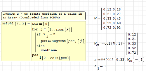

Hello Valentino!
This snippet downloaded from the forum long time back.
Credit to the author, but cannot remember.
There may be other short cuts too.
Cheers.....
Erick Valentino 5/6/2021 7:32:00 AM, Oscar Campo 5/10/2024 7:12:00 PM
#3 Posted: 3/27/2021 7:32:48 AM
NDTM Amarasekera
NDTM Amarasekera
To find the indices of an array of values.
Cheers.....

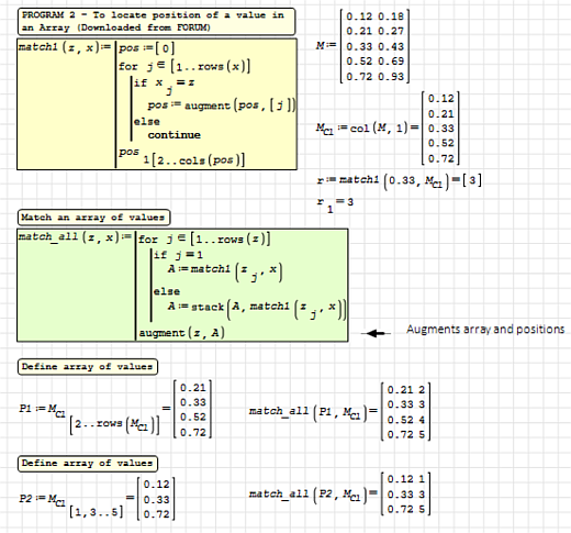

#4 Posted: 3/27/2021 8:33:47 AM
These 4 are from a much larger compendium.
You will go a long route with them.
Utilities Matrix Truth Table [Locate row_col].sm (45.47 KiB) downloaded 1298 time(s).
Utilities Matrix Locate Array1 Array2.sm (70.25 KiB) downloaded 1508 time(s).
Utilities Matrix Truth Table [Locate row_col] COMPANION.sm (153.6 KiB) downloaded 1402 time(s).
Utilities Matrix Treasury_1.sm (423.07 KiB) downloaded 1544 time(s).
#5 Posted: 5/6/2021 7:35:13 AM
Erick Valentino
Erick Valentino
7 likes in 29 posts.
Hello Valentino!
Cheers.....
Thank you very much, it worked perfectly for me,
the method you teach is very useful.
Thanks for taking the time and sharing your ideas.

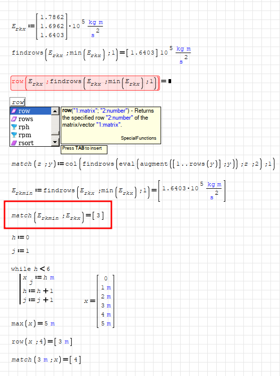

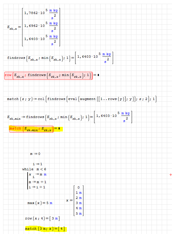

#8 Posted: 7/27/2023 4:04:49 PM
Beyaz
Beyaz
0 likes in 19 posts.
hey,
i have a some problem.
i hope someone can solve this problem too.
in the first exampe "match" its not working but in the second example it works. i dont know why

Hi Beyaz,
For first warning, row() expect a real pure number for second argument.
Your findrows() result is a number with N unit.
Due to your second problem;
I think commas in your subscripts makes the bug.
When they are deleted, your function match() works.
PS: Please provide your problematic file next time.
Rewriting your entire screenshot is cumbersome.
match.sm (10.75 KiB) downloaded 1463 time(s).

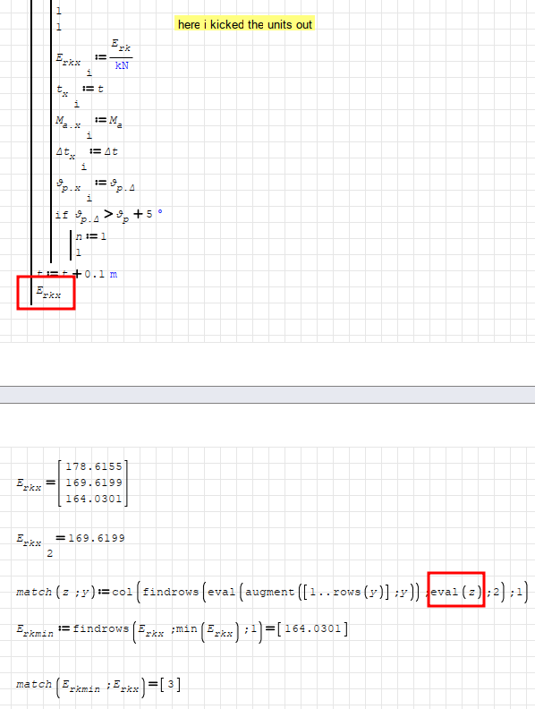

thanks overlord
sorry, you are right, next time i will add the file.
i tried it but it doesnt work. this time i add the file.
vogt.sm (636.54 KiB) downloaded 1595 time(s).
//I solved it like this
#12 Posted: 7/28/2023 5:03:03 PM
598 likes in 1,380 posts.
Your while loop shouldn't produce E.rkx.
At least my computer doesn't.
There should be an E.rkx output at end of it.
I would solve eval() problem like this.

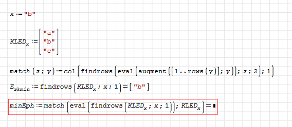

#14 Posted: 1/5/2024 4:37:40 PM
Beyaz
Beyaz
hey guys,
Your suggestions were very helpful, but is it possible to rewrite the function so that strings are also can be match.
Im looking for the Index of "b" ->[2]
KLED.sm (4.45 KiB) downloaded 1556 time(s).
#15 Posted: 1/6/2024 3:48:08 AM
The result of findrows() is a matrix, even if there is only one match (exept for no matches, then the result is the number zero)
Converting it to a scalar, seems to help. The same could be applied to the overall result to remove the matrix.
Yet, there is a shorter way to get the index. This, however, won't work for multiple matches.
