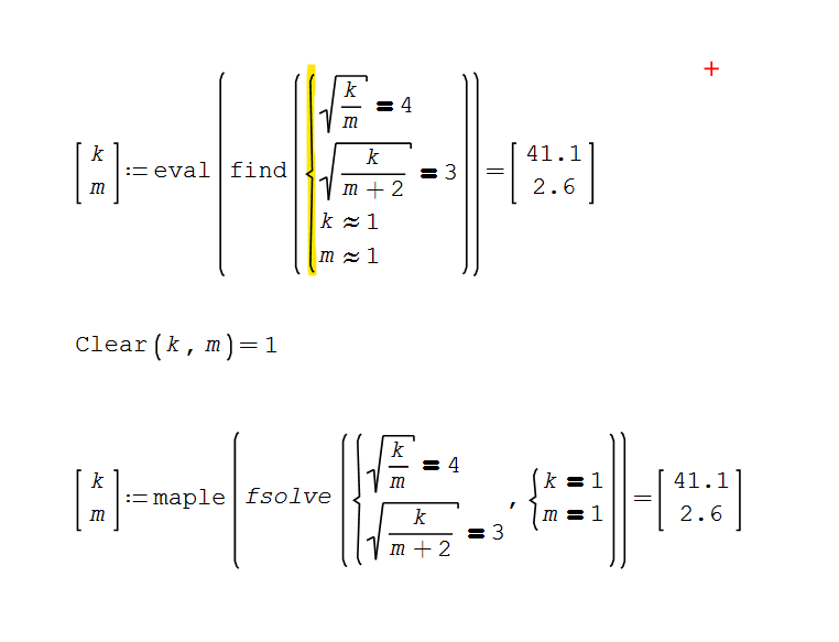

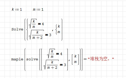

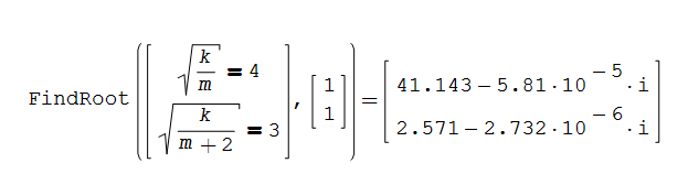

Why cant get the same results?
123.sm (4.97 KiB) downloaded 535 time(s).
Edited 8/28/2025 7:11:13 AM
#5 Posted: 8/28/2025 9:58:27 AM
Oscar Campo
Oscar Campo
135 likes in 309 posts.

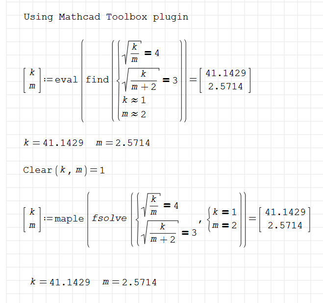

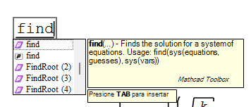

Use sys() to define the system of equations
regards,
Oscar
ioan92 8/28/2025 6:20:11 PM, netsonicyxf 8/28/2025 11:11:31 AM

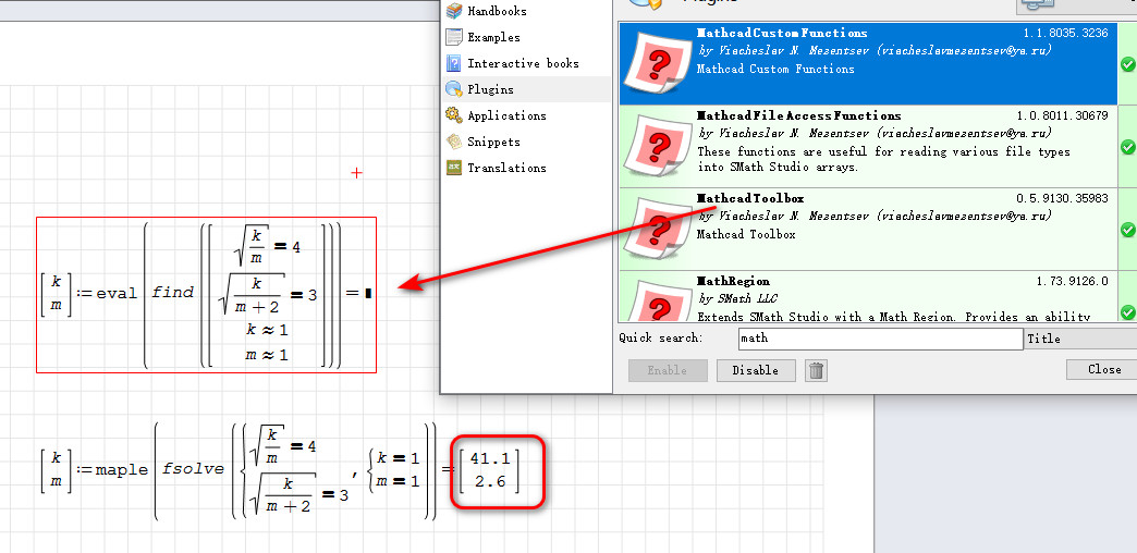

#6 Posted: 8/28/2025 2:36:50 PM
579 likes in 1,348 posts.

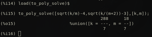

I am a little bit surprised Maxima couldn't parse root function.
Edited 8/28/2025 2:39:06 PM
#7 Posted: 8/28/2025 6:22:15 PM
Hmm, maxima needs poly solve enabled for these kind of equations.

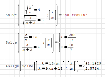

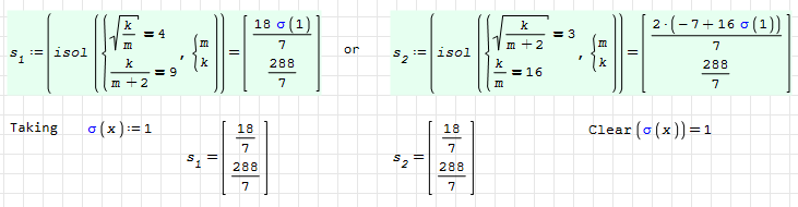

Hi. Using isol, which is written in SMath. It can't handle both roots at the same time, but it can one at a time.
isol.sm (217.23 KiB) downloaded 541 time(s).
