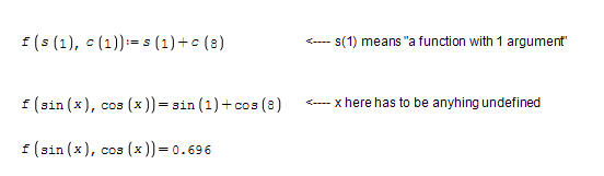

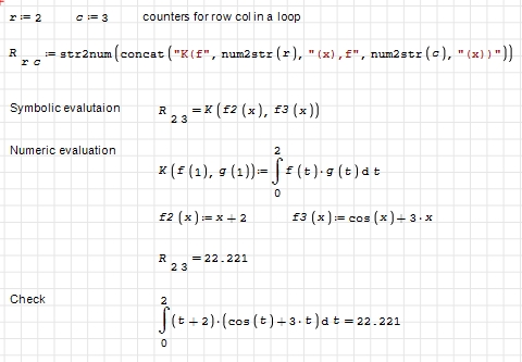

in my recent calculations I needed to have a function that takes two funtions as parameters
and calculates some values. Something like:
k_f(s;c)=s(1)*c(8)
k_f(sin; cos)=
Trying this in SMath Studio unfortunately failed.
Is is possible to implement such a thing in SMath Studio?
Yours,
Pawel Wierzba
#2 Posted: 7/7/2021 8:32:56 AM
Yes it is possible, see the attached image
#3 Posted: 7/7/2021 9:31:23 AM
Paweł Wierzba
Paweł Wierzba
0 likes in 6 posts.
Thank you very much. Indeed, it works, even with functions with more arguments than one.
Sorry for asking a question about something that has already been implemented.

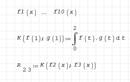

#5 Posted: 7/7/2021 10:11:06 AM
Paweł Wierzba
Paweł Wierzba
0 likes in 6 posts.

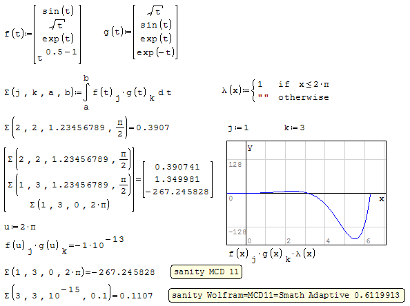

Thank you for the advice. Fortunately, standard way of defining functions is well known to me.
Unfortunately, I had to pass functions as arguments, rather than define them the "standard way".
I had several functions and some coefficients to be calculated, based on them.
Something like the example below.
If done the standard way, it would involve a LOT of writing.
Beautiful!
Great!
SMath has that awesome characteristic, so you can use that "standard way" for defining functions.
Good luck with your job!

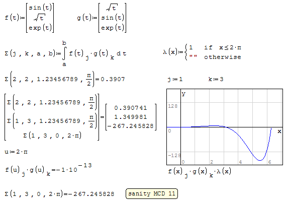

#12 Posted: 7/7/2021 6:02:38 PM
#13 Posted: 7/7/2021 8:17:37 PM
Interesting solution, promising to be very useful.
I wonder if it could be done with other functions.
It would really shorten a lot of thing if was possible.
Especially with external plugins function calls.

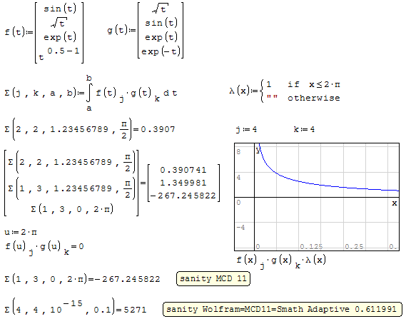

#16 Posted: 7/8/2021 9:45:19 AM
Thank you for help, especially the comment about potential problems
with the integrator and illustrative examples.
I posted the wrong image ... that's the right one.
Don't drop dead by how far simple integration can fly in the blue !
#17 Posted: 7/8/2021 2:44:44 PM
Thank you for help, especially the comment about potential problems with the integrator and illustrative examples.
The 'thanks' button' never worked.
1. The previous image as *,sm
2. My Integration tool box.
Please, don't hesitate for + ... Jean
Integral 000000000000 vectorsf(j,k,a,b).sm (13.15 KiB) downloaded 1650 time(s).
Integral 00000000 MASTER ToolBox.sm (477.13 KiB) downloaded 1669 time(s).

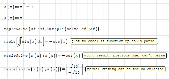

#18 Posted: 7/8/2021 4:25:50 PM
598 likes in 1,380 posts.
Looks like line() mysteriously solve the issue.
I have come across similar to this behavior before.
#19 Posted: 7/8/2021 5:21:01 PM
Hi. For help understanding what's happen: that behavior is similar to the SetDelayed in Wolfram Mathematica language: https://www.wolfram.com/language/elementary-introduction/2nd-ed/39-immediate-and-delayed-values.html
