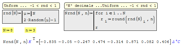

Is this correct?
I'm trying to remove the units, do the calc and put the units back. But this is catch. It changes my units from Celsius to Kelvins.
Is this correct?
Yes, because units are stored in base units (hoover over a variable definition to see it). Moreover temperatures are handled as absolute units, so be carefult if you use any relative units like °C, in this case there are the temperature difference units to help.
