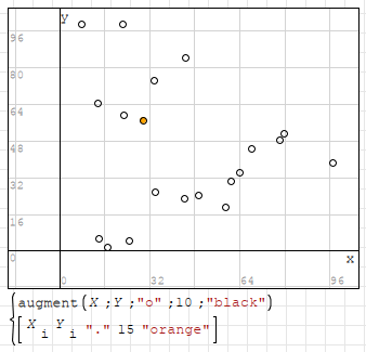

I can only remove the blue lines by making them white.
Is this my defect or the SMath defect?
Points.sm (8.34 KiB) downloaded 1384 time(s).

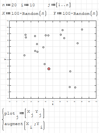

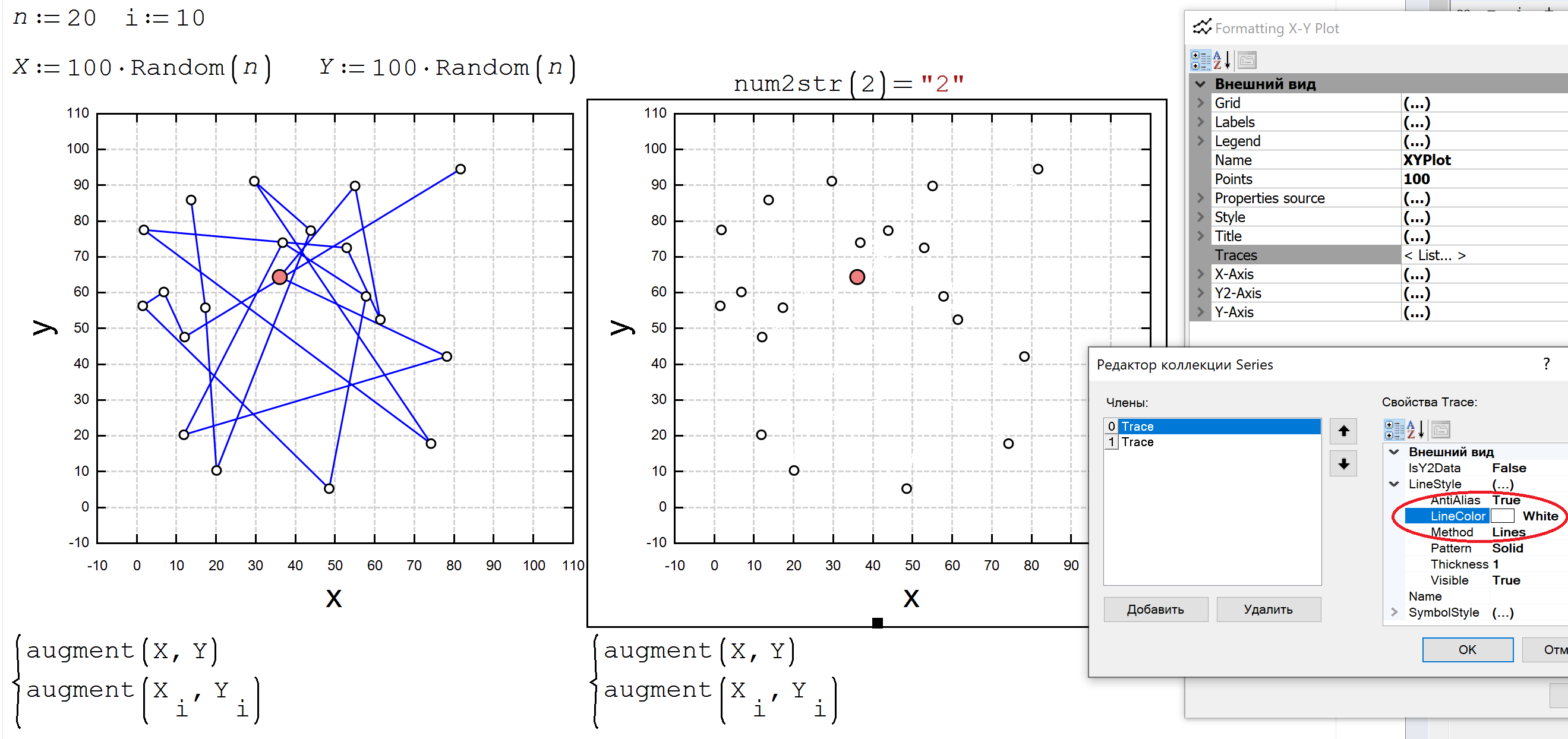

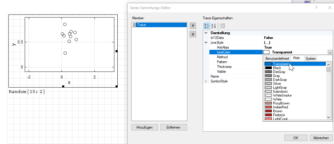

#3 Posted: 10/25/2023 5:54:06 PM
WroteI can only remove the blue lines by making them white.
Is this my defect or the SMath defect ?
I use this feature commonly.
