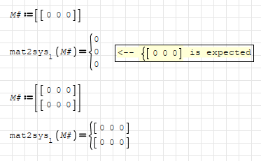

When parent matrix has one matrix element, conversion is wrong.
More than one child matrices, no problem.
Matrix converts to sys() correctly.

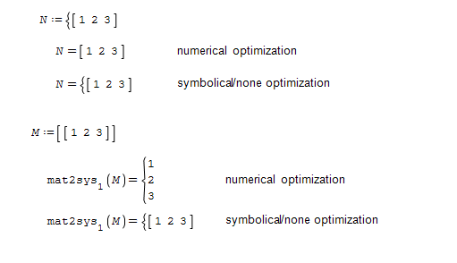

this is related on how SMath manage the systems. To avoid it, mat2sys must be evaluated with symbolical/none optimization.
