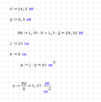

You can change the units on any result by doing the same thing as long as they are equivalent units.

I might add that you need to press tab to insert each unit.
So for kN/m^2, you need to type in kN, press tab, then type / and then type in m and press tab, then type in ^2 to make it square.
