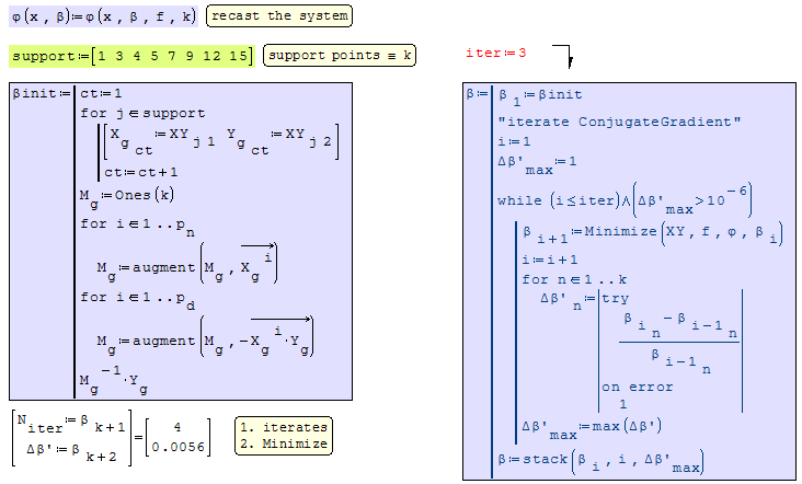

Is there a way to change the display font?
The unique font style is "Courrier New" the most comfortable math font.
In Mathcad, Tom used Tahoma next acceptable.
Some Greek are not too nice in Courrier New.
Neat advantage Smath Courrier New: all work sheets are uniform.
So far more comfortable than Arial, Times New Roman ...
