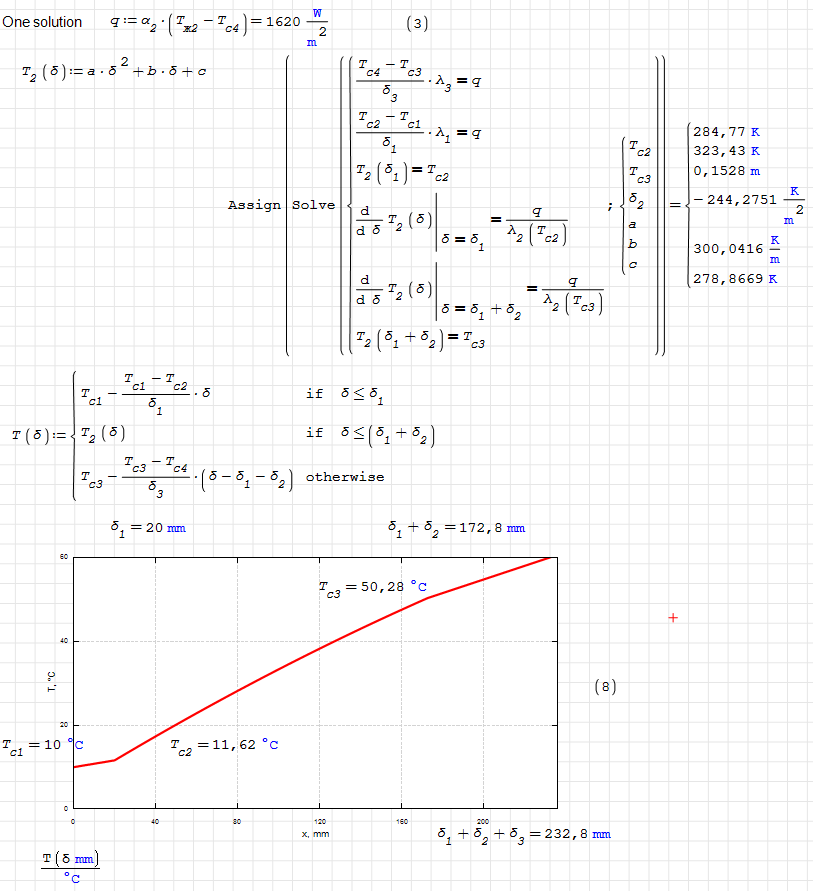

I am trying to plot a temperature field in a three layer wall. There is no problem with the outer layers. But there is a problem in the middle layer - there should be a parabola, not a straight line. How to draw this parabola in the simplest way - with one formula. I know the hard way.

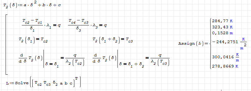

#4 Posted: 7/15/2023 7:17:49 AM
1,355 likes in 2,270 posts.
Don't know if that is the simplest solution.
Stenka-3-eng.sm (58.13 KiB) downloaded 1208 time(s).

#5 Posted: 7/15/2023 7:26:46 AM
Valery Ochkov
Valery Ochkov
66 likes in 690 posts.
Fine!
And if the dependence of thermal conductivity on temperature is more complex, obtained, for example, through interpolation of discrete data. I would like to see an integral in the solution!
#6 Posted: 7/15/2023 7:32:04 AM
Version with mathcad block to collect the equations
Stenka-3-eng1.sm (59.5 KiB) downloaded 1238 time(s).

One solution from Alan Stevens
Stenka-3-Alan.sm (60.35 KiB) downloaded 1191 time(s).
