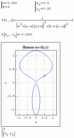

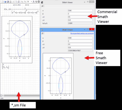

Commercial Smath Viewer does not display the graphical X -Y Plot
Carlos
Human eye.sm (6.4 KiB) downloaded 875 time(s).
Human eye_Comm_and_Free.zip (1.07 MiB) downloaded 243 time(s).
Carlos

I understand your point: Commercial Viewer does NOT capture the plot.

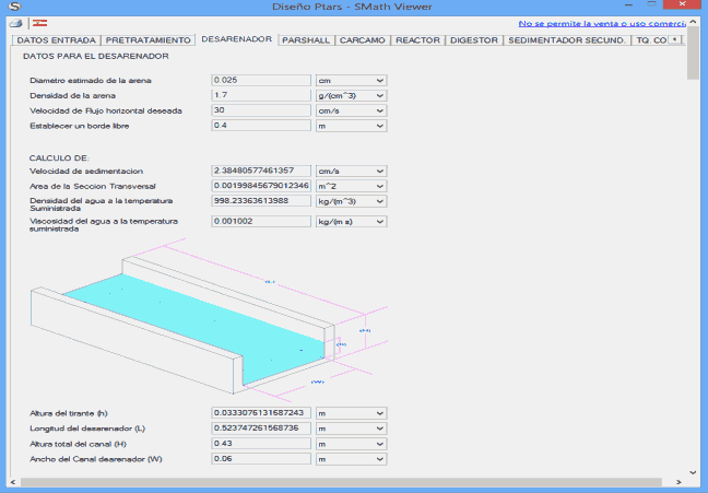

I explain how I see the use of Smath Viewer.
A program was developed to calculate or design something , in order that almost anyone can use it with minimal knowledge.
The person using it , simply by changing the input data , this can calculate or design element in smaller or larger size .
The person does not see the formulas or source code . Then Smath Viewer is ideal to be used by almost anyone .
In my case, I am trying to develop a program to calculate and design Wastewater treatment Activated Sludge fine bubbles Plants .

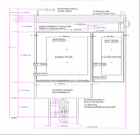

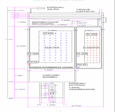

The graphical X -Y plot , use it to graphically display the distribution of air diffusers .
Some screenshots
Small Plant (two diffusers).
A slightly larger plant (60 and 48 diffusers)

WroteCommercial Smath Viewer does not display the graphical X -Y Plot
This is because SMath Viewer Pro doesn't support third-party plug-ins (because of technical challenges). I'm working on it...
#6 Posted: 8/5/2016 3:34:52 PM
Andrey
Thanks for your reply-
But I have curious to know , because the free version of Smath Viewer does support the Plugin X -Y Plot, and PRO version does not , if it is assumed that the PRO version has more features .
Carlos
Carlos
#7 Posted: 8/5/2016 6:11:22 PM
You are right. But the reason of why SMath Viewer Pro costs nothing is that it is not actually ready yet.
It will support third-party plug-ins when I will implement it.
