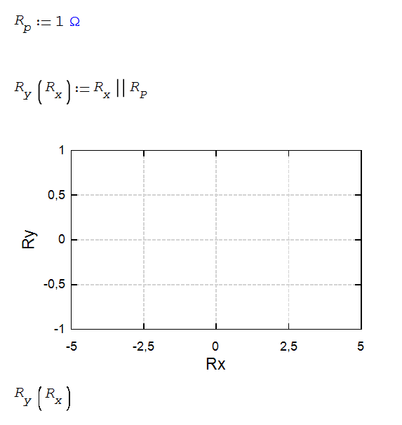

I am trying to plot electrical resistance using Electrical Engineering Library and X-Y-Plots Plugins but it does not seem to work:
Can anyone help me plot this?

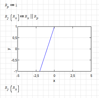

Delete the ohm unit in Rp.
Usually you shouldn't use units while plotting.
For information, this includes most numeric solver functions too.
#3 Posted: 10/16/2021 7:46:20 PM
598 likes in 1,380 posts.
Or if you will really need units;
Try to eliminate or add them in the input data.
It is to avoid them being used in plot.
Or to avoid conflict between unit-ed numbers and not unit-ed.
When you use Rx in your function, it can't be EEL_par with 1 ohm.
Plot try to use Rx as an number not a unit added number.
You either add unit to Rx or do opposite.
Opposite is eliminating all units of other variables.

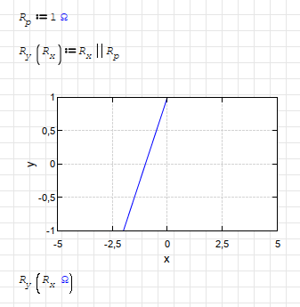

So how did you add the Ohm symbol under the plot? It won't let me add a unit there.
#7 Posted: 10/17/2021 4:23:47 PM
1 - Hit multiply after Rx;
2 - (Type W in place holder, place Ctrl+G) or (Click ohm from right pane);
3 - Placeholder shall appear, either double click or press tab to insert Ω as unit.
If you are not typing units after numbers, this is the way.
You can also type ' between step1 and step2.
Units can be typed or chosed with this way more quick.
This will directly open placeholder scroll menu.

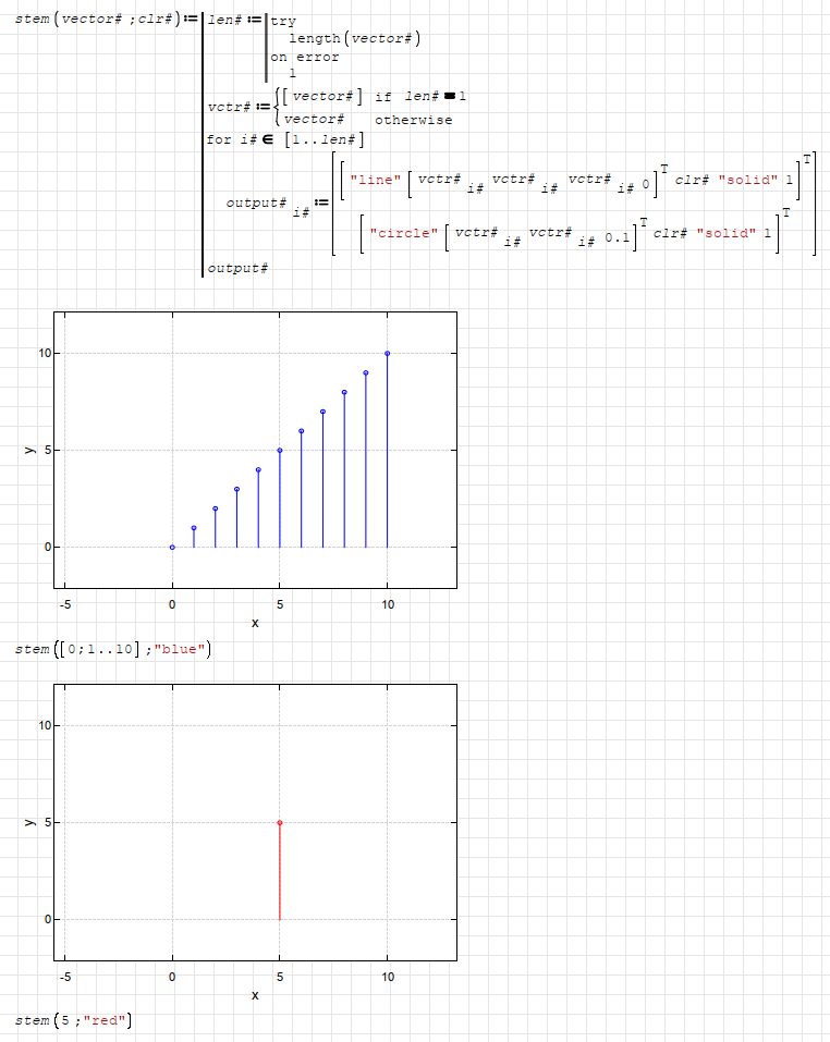

I don't know if there is a stem equivalent for smath plots.
But you can create your own function for that purpose.
stem.sm (8.62 KiB) downloaded 1161 time(s).

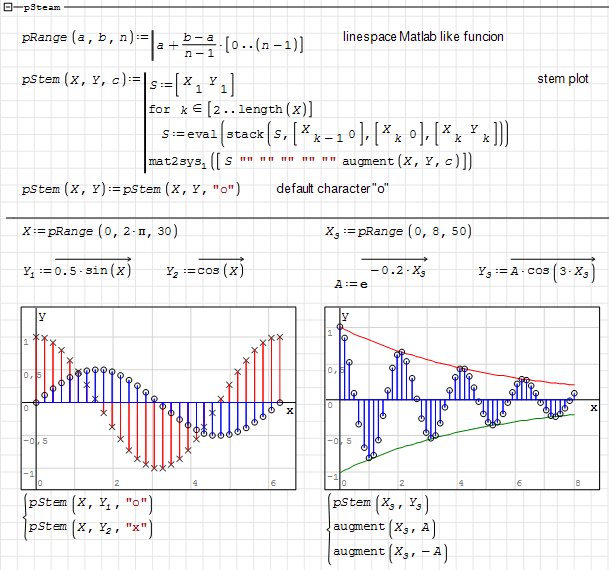

Hi. In addition to the overlord solution, this is another approach.
stem.sm (12.15 KiB) downloaded 1133 time(s).
