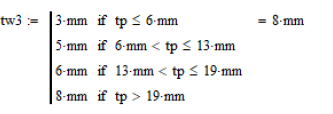

All,
I am new user, need your help how to create this type of equations in Smath

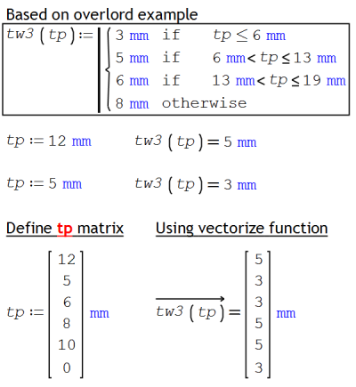

if_function.sm (12.23 KiB) downloaded 1284 time(s).
#3 Posted: 6/15/2023 11:42:20 AM
NDTM Amarasekera
NDTM Amarasekera
130 likes in 352 posts.
Based on program by overlord.
if_function_ndtma.sm (27.85 KiB) downloaded 1290 time(s).

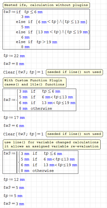

#5 Posted: 6/16/2023 6:54:18 AM
... from the drop down fx menu.
Making it a function as Amarasekera did is much more sensible solution.
