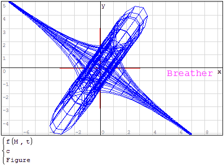

For expressiveness, I sometimes change the foreshortening
Rotate Breather Water MillMod.sm (1002.46 KiB) downloaded 1278 time(s).

Hello Ber7 !
I can see what you are trying to do ... let me find "Wind Mill" equations,
if they exist ?
Cheers, Jean
if they exist ?
Cheers, Jean
