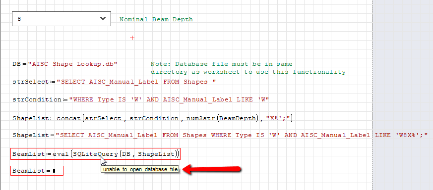

Chris, I suppose I may be that user developers hate, but I'm playing around with the plugin without knowing what I'm doing, modifying an old worksheet for designing beam web stiffeners, referencing back to the SQLite tutorial for syntax and whatnot, to learn to use SQL as I go. I'm loving this so far! But I did mess up a Select statement, and everything froze up (graphically), although I could still save the worksheet. So I did a save as, closed it, reopened it, but now the eval(SQLiteQuery(DB,...) statement throws an error that it can't open the database file. I thought maybe the file got corrupted, but I can open it through that SQLite DB Browser Portable you linked to, so it appears to still be a valid database file. Any suggestions?

To add to my initial report, I did recopy over the db file from your zip file to my worksheet directory in case it was corrupted. But then I noticed that your sample worksheet in its own folder with its own untouched copy of the db file also gave the same error, so I thought maybe the plugin itself had an issue rather than the data file. I re-downloaded your 2 zip files, deleted the plugin from the SMath directory, and re-extracted to that directory. Then when I reopened your AISC example sheet, it was able to open the database file and pull the W44 beam depth as it before. Then I opened my own worksheet that had the initial problem, and SMath gave the same unable to open database error. Then opening your example file again produced the same error. I changed the name of the db file in the sample folder, and the reference to it in the same sample worksheet, and it worked. So then I did the same thing to the db file I had copied over to my calcs folder, and the file reference in the worksheet I was editing, and it started working again. So it seems to have been something related to the database name. Maybe changing the name forced a connection to reset that somehow became invalid but persistent when it froze up earlier? It seems like something is persisting from 1 worksheet to the other. If I open my worksheet with DB:="AISC Shape Lookup2.db" and then your sample with DB:="AISC Shape Lookup1.db", with the appropriately named db file in each worksheet's respective folder, your sample worksheet stops working. If I change the DB assignment to the "2" file, it works again. And now neither one works regardless of what I change it to. I'm out of ideas there.

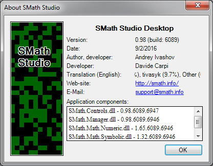

SQLLite Plug-in can be installed using Extensions Manager only starting from SMath Studio 0.98.6089. Previous versions of the program cannot install this plug-in correctly. I would highly recommend you to upgrade.
BTW: If you see error message with "GUID: 00000000-0000-..." then you are using old version of the plug-in. Please delete it and install latest one using Extensions Manager with SMath Studio 0.98.6089 or higher.

That's odd. I had already updated to 6089 first thing this morning. Last week, I had gotten the plugin to work doing the original manual extraction of Chris's zip file to the plugins directory, but then it had stopped working at one point, and it seemed like I could only get it to open a database file once after each re-install. Any subsequent attempts to open a worksheet with SQL statements would generate the error that it couldn't open the db file. So after updating SMath to 6089 this morning, I tried and none of the worksheets, mine or Chris's, would open without errors, so I used the delete and install functions in Extensions Manager (6089) to delete the SQLite plugin and reinstall it. It appears to successfully install it, although now I get the error messages previously posted. But just to confirm, I just now deleted and installed using Extensions Manager, in 6089 (as confirmed in the screenshot below), and still get the same error message with the all-zero GUID.

Thanks, Davide. That does eliminate the zero GUID error on subsequent opens of those worksheets, although the "Unable to open database file" error is still present. Recalculating, saving and reopening, changing variable names, nothing I've tried seems to help.
Your example works perfectly for me (even without eval(...)). Please attach a worksheet and the database, so we can try to understand where might be the issue.

Taking in account error message returned by SQLLite plug-in it looks like latest version of the plug-in installed correctly, but for some reason it cannot find a file (or similar issue, like the file cannot be opened for read operation).
Please try to specify absolute path to the *.db file and ensure this file not used by any other application. If it will help, then it seems there is a bug in the plug-in (may be not, but it is just a first impression).

Yep! Absolute path worked. Thank you, Andrey! I had assumed that since the original example worksheet didn't give a full path name to the database file, that it was a relative path based on the database file being in the same folder as the worksheet. I had originally extracted Chris's example zip file to my desktop, then copied the db file over to a Dropbox folder I keep all my SMath worksheets in. I thought I'd been working with the db file in that projects folder, but it was apparently still referencing back to the one in the extracted zip file on my desktop. Changing the name back to match that made my worksheet start working again. Then I added the full folder path to the DB:="..." assignment in that and another test worksheet, and it could correctly open each database file. I'm not sure how the link to the original extract folder was persisting, but specifying the full path seems to eliminate that issue.

Please note that if you double-click the .sm, then SMath opens with the directory where the .sm located as current path; so all subsequent relative paths will be searched under this directory. But if you start SMath from, say, desktop shortcut, and then open the .sm from it, then current directory will be that was specified in the shortcut. The same will happen if you opened SMath by double-clicking one .sm, (and its path is now current directory), and then from that SMath open another .sm from another directory: the second directory won't be current one.
So, using relative paths in SMath is error-prone. If SMath for each .sm would make its own current path as one where the file is, regardless of opening method, then it would be good. For now, I wouldn't advise anyone to use relative paths.
This explains everything, thank you Mike
But this is even poor implementation in the plugin and can be solved easily (fix the same issue yesterday in my WriterRegion)
  1. Check if path is rooted (absolute); if yes go to step 3, otherwise go to step 2;
  2. If the path is relative, build an absolute path;
  3. Use the output path
string path = "whatever";
// internal checks: a filename is specified, etc, etc, ...
path = Environment.ExpandEnvironmentVariables(path);
if (!String.IsNullOrEmpty(context.FileName) && !Path.IsPathRooted(path))
   path = Path.Combine(Path.GetDirectoryName(context.FileName), path);
