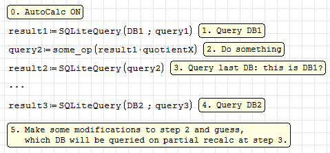

  1. Could you consider using a identifier (number or string) as a "handle" to open connection? For example,
    SQLiteOpen("connection1","path1"="open"
    SQLiteOpen("connection2","path2"="open"
    m:=SQLiteQuery("connection1","query"
    query2:=<some processing involving m>
    SQLiteQuery("connection2",query2)
    <some other processing with both connections 1 and 2>
    Or the SQLiteOpen could return the numeric handle on succcess, or an error with a description on failure.

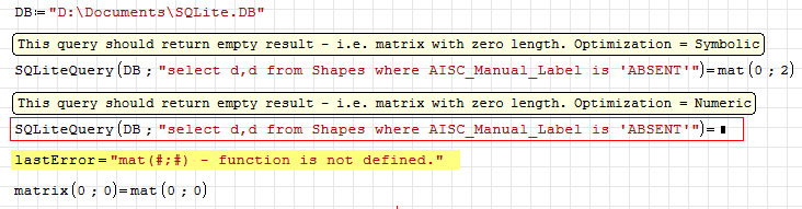

  2. Quote
    If no fields are returned by the database engine, the function will return the string "No Results"
    Imo, it would be better to return matrix(0,0) in this case. And please return a matrix in all cases, even on single return, thus eliminating the need for conditionals in the calculations. If one knows that only single return will come, this may be handled by simply using el(result,1).
Yes, thank you. This is exactly what I have done, SQLiteOpen will now return the index of the database connection that has just been opened, starting with 0. To prevent memory leaks associated with undesired reopening of database files and to speed up sheet recalculation the SQLite plugin will not reopen the same file again and instead return the handle that has been generated when the file was opened the first time. If the file has since been closed it will be reopened but the handle will not change.
A very good suggestion, implemented straight away.

Partial recalculation seems to work as far as I can tell.
You are quite right, closing the database connection in the end makes a full recalculation necessary.
Closing the database file is not necessary if the database is only read. At the latest when SMath Studio is closed the database connections are terminated. I am however not sure whether "SQLiteClose" can be safely ignored if write operations to the database have been performed.
Opening a file will not impose additional overhead if the file is already open. The plugin will now recognise this and simply report the handle.
You can always collect any handle opened and close all them internally when SMath closes (Dispose() method)

But I see a problem with returning empty result sets:
Something's wrong with the approach I suggested (using matrix(0,n)). Maybe Andrey could suggest something here?
I think the approach "matrix as result" is good, maybe there is something to improve in the SS logic. If you try to assign matrix(0,n) to a variable, you can show mat(0,n) in a standalone display of the result with numeric evaluation if at definition is stored symbolically, but not if it is stored numerically (that is the same error while you are trying to display the inline result); this affects also rows()/cols()/length() (unable to process the variable when it is stored numerically). I'll talk with Andrey about this.
BTW 'NULL as result is very good idea, +1 for this.

WRT empty matrices. There used to be yet another application for them: using as initializers for loops, to assign an empty n-col 0-row matrix to a variable, and then use stack() uniformly in a loop to fill it (of course, if the number of rows is known in advance, that may be done differeently and more efficient). This functionality was definitely available at some point (unfortunately, I cannot find a link to it atm, because I explained this technique in Russian forum, that is unavailable now).

I know about this useful feature, that's why I think this particular form should be enforced

  • Removed single argument SQLiteQuery due to inconsistencies with partial recalculation.

I completely oversaw this issue, to preserve consistency and repeatability even with partial recalculation I have removed the single argument version of SQLiteQuery
