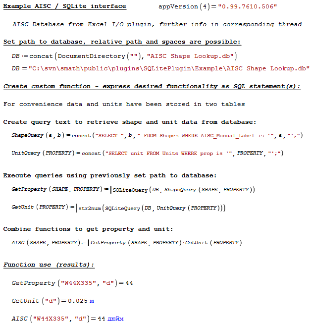

Example

  • Since it is not possible to use "=" within a SMath string this has to be considered when designing a query. "IS" and is usually a suitable replacement. "IS NOT" serves as a replacement for "!="
    The boolean 'equal' (Ctrl + =) works very well (tested). Thanks Martin Kraska and Mike Kaganski for pointing out my error

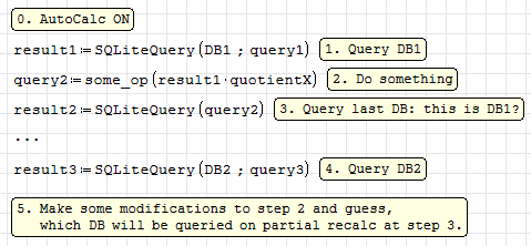

  1. Could you consider using a identifier (number or string) as a "handle" to open connection? For example,
    SQLiteOpen("connection1","path1"="open"
    SQLiteOpen("connection2","path2"="open"
    m:=SQLiteQuery("connection1","query"
    query2:=<some processing involving m>
    SQLiteQuery("connection2",query2)
    <some other processing with both connections 1 and 2>
    Or the SQLiteOpen could return the numeric handle on succcess, or an error with a description on failure.
Yes, thank you. This is exactly what I have done, SQLiteOpen will now return the index of the database connection that has just been opened, starting with 0. To prevent memory leaks associated with undesired reopening of database files and to speed up sheet recalculation the SQLite plugin will not reopen the same file again and instead return the handle that has been generated when the file was opened the first time. If the file has since been closed it will be reopened but the handle will not change.
Imo, it would be better to return matrix(0,0) in this case. And please return a matrix in all cases, even on single return, thus eliminating the need for conditionals
A very good suggestion, implemented straight away.
It is possible to use "=" in SMath strings.
Actually you can have = in strings.
Thank you for pointing out my mistake, tested and found to be working nicely, updated in original post.
For some reason, SMath Studio 0.98.6081.26558 doesn't start with the plugin, so I cannot test it. Does it handle partial recalculations? Doesn't closing in the end prevent partial recalcs? Is it possible to skip closing the connection altogether and thus skip overhead opening new connection on recalc? I.e. does it internally checks in SQLiteOpen if the connection is already open?
I'll download 0.98.6081.26558 and try to solve the issue as soon as possible.
Partial recalculation seems to work as far as I can tell.
You are quite right, closing the database connection in the end makes a full recalculation necessary.
Closing the database file is not necessary if the database is only read. At the latest when SMath Studio is closed the database connections are terminated. I am however not sure whether "SQLiteClose" can be safely ignored if write operations to the database have been performed.
Opening a file will not impose additional overhead if the file is already open. The plugin will now recognise this and simply report the handle.

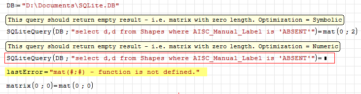

SQLiteQuery(0,"select * from Shapes"
gives me an error "The cast is illegal" (translated from Russian - specific wording may differ).
SQLiteQuery(0,"select * from Units"
works OK
I suppose it may have something to do with decimal separator? Or a problem when returning an empty value?

But I see a problem with returning empty result sets:
Something's wrong with the approach I suggested (using matrix(0,n)). Maybe Andrey could suggest something here?
С уважением, Михаил Каганский

#13 Опубликовано: 29.08.2016 14:32:52
I think the approach "matrix as result" is good, maybe there is something to improve in the SS logic. If you try to assign matrix(0,n) to a variable, you can show mat(0,n) in a standalone display of the result with numeric evaluation if at definition is stored symbolically, but not if it is stored numerically (that is the same error while you are trying to display the inline result); this affects also rows()/cols()/length() (unable to process the variable when it is stored numerically). I'll talk with Andrey about this.
BTW 'NULL as result is very good idea, +1 for this.
Christopher Bietz 31.08.2016 08:56:00, Mike Kaganski 29.08.2016 18:14:00

I must yet get used to your new status as SMath co-developer. I haven't yet had a chance to congratulate you with that Thank you for all your past and future contributions! And I will remember to address my questions WRT SMath internals to both of you from now on.
WRT empty matrices. There used to be yet another application for them: using as initializers for loops, to assign an empty n-col 0-row matrix to a variable, and then use stack() uniformly in a loop to fill it (of course, if the number of rows is known in advance, that may be done differeently and more efficient). This functionality was definitely available at some point (unfortunately, I cannot find a link to it atm, because I explained this technique in Russian forum, that is unavailable now).

Thanks for the congratulations Mike. I'm very grateful to Andrey for this opportunity
I know about this useful feature, that's why I think this particular form should be enforced

I have updated the plugin
with the following changes (link in initial post):
  • Removed single argument SQLiteQuery due to inconsistencies with partial recalculation.
  • Null entries in database return custom unit 'NULL and are now distinguishable from empty strings, simplified code.
  • Fixed and improved the example file
  • Added typetest table to example database and tested every case successfully
Thanks yet again for all the useful feedback I've received.
I completely oversaw this issue, to preserve consistency and repeatability even with partial recalculation I have removed the single argument version of SQLiteQuery

I see some fancy column names in the sample DB (like "h/tw" ); how do I query for them
Either of the following will work:
Select `twdet/2` from Shapes;
Select 'twdet/2' from Shapes;
