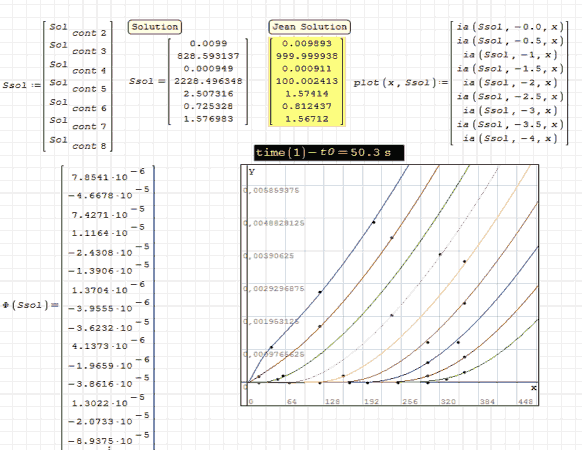

For this particular example, Carlos algorithm spits out in < hart beat !
Thanks again Carlos, it will surely help revamp some/many of the GenfitMinimize.
Levenberg_Marquardt_Code_CBG Copy.sm (65.28 KiB) downloaded 1254 time(s).

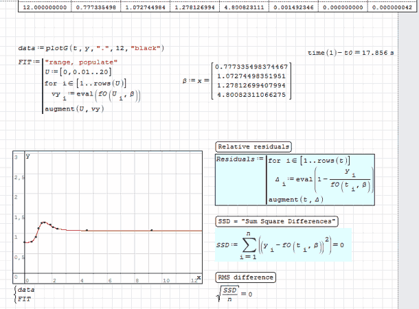

#6 Posted: 9/21/2018 4:50:22 PM
WroteHello Jean
Here is the L-M file that works with your example.
Thanks Carlos for doctoring.
By some regrouping, timing dropped from 3.8 min down to 2.6 min.
Niece Smath document for classroom and publishing.
Genfit Pharmacokinetics L-M Copy.sm (60.57 KiB) downloaded 1131 time(s).
