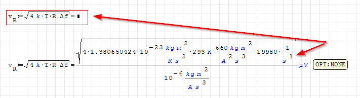

I had a worksheet that worked in the past, but now it doesn't, saying "operation cannot be performed with units", because it's sqrt(V^2)? But if I break it up into two steps it works:

Works for me with SMath 0.97.5301, but I see you are using 0.97.5154
Could you try to open your file with the latest Nightly build?

yes, it works in the Nightly build. thanks.

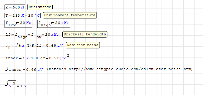

Actually, no, the original worksheet is not working, only the copy that I uploaded

I've already seen this bug, sometimes comes to light...
when the SMath engine output unitary exponents on units, square root fails.
Refreshing the worksheet alternately works/doesn't works.
[EDIT] Added in the BTS: SS-177
