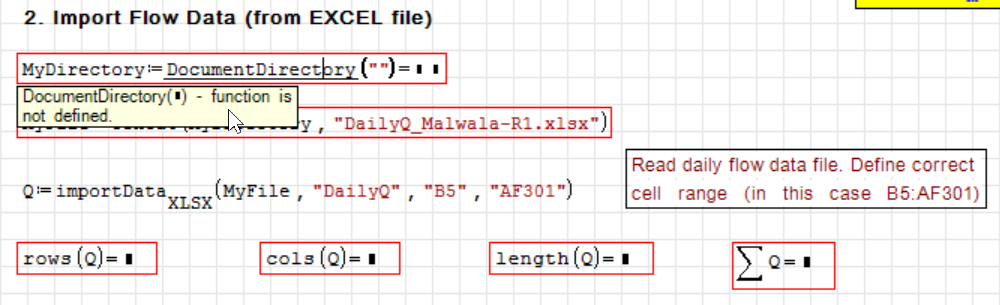

Thank you very much Andrey for the latest SS 98.6046
However, I get an error "DocumentDirectory(.) - function not defined", when trying to import an EXCEL data file.
Several attempts with clean reintallations did not work.
The SS file and Excel data file are attached.

Confirmed. My fault. Will fix later today.

Fixed. New beta version released.
