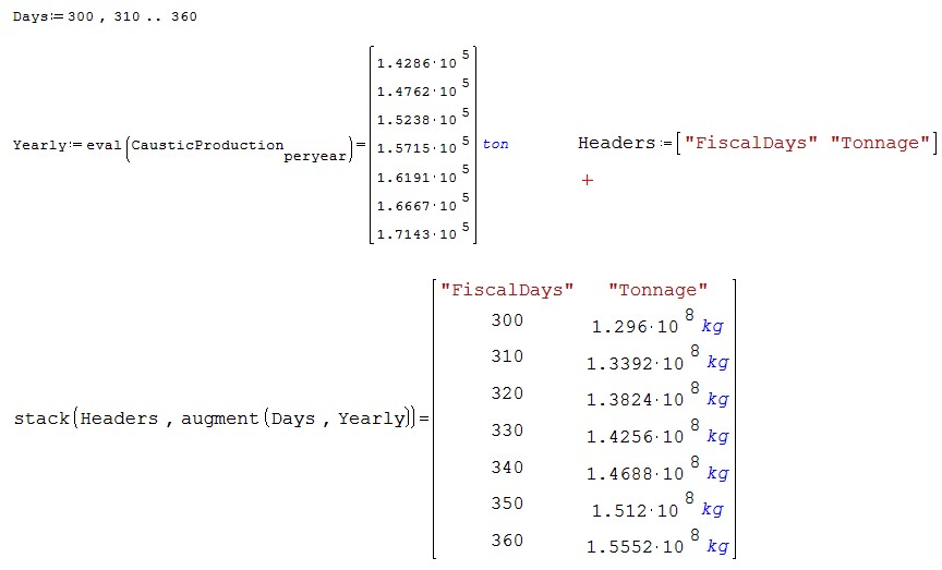

The question is simply clear ...its should be a matter of removing or adding x3 zeros
aMIR.sm (10.5 KiB) downloaded 977 time(s).

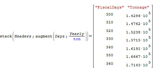

#2 Posted: 5/14/2018 5:36:20 AM
1,443 likes in 2,935 posts.
Simple as the question

#3 Posted: 5/14/2018 6:00:37 AM
usamakhan
usamakhan
3 likes in 79 posts.
Thanks ...but can you tell me what is the wrong in this kg <> ton ...it should just reduce the power to 10 from 8 to 3 without changing the values

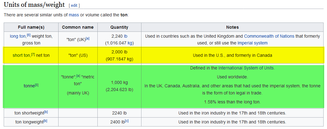

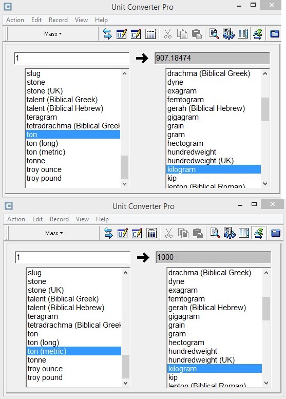

You have to use 't (metric ton) because 'ton here is the US "short ton"
