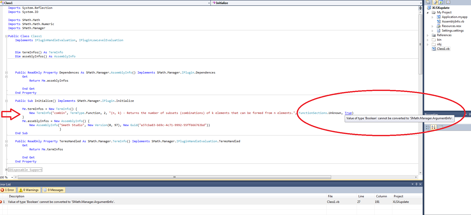

Good day,
I am attempting to follow through tutorial on plugin development in VB.NET:
https://smath.com/wiki/GetFile.aspx?File=Developer%20Guide/Tutorial%20on%20creating%20plugin%20for%20Smath.pdf
I have not reached a glorious conclusion yet, however even now I can notice something to be incorrect (see screenshot).
Could someone please point out what I am doing wrong? Please keep in mind that I have never attempted to piece few lines of code together before and hence might miss obvious things. I am attaching my project folder.
Thanks!

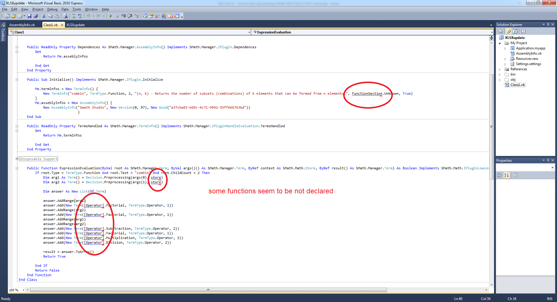

The function argument is ByRef context As SMath.Math.Store -> change it into ByRef store As SMath.Math.Store (or change the store variables into context)
use Operators instead of Operator

Thank you, Davide - I am just trying to get the tutorial working before I start tinkering with anything else..
Also what I am trying to do here is to come up with a plugin that will write array of data to excel using Interop.Excel to any sheet/cell (it will recalculate the file after transfer automatically). I have looked at enough tutorials to believe that I should be able to make it work once I figure out how to read array of data from SMath to VB in a form similar to:

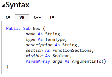

You have to delete the third argument (old syntax, I guess)
