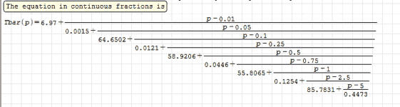

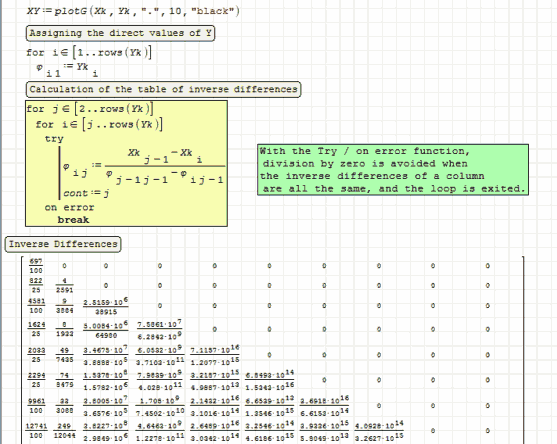

#5 Posted: 5/9/2018 6:39:36 PM
Hello Jean
Updated version of Interpolation using the Thiele algorithm in cuntinuous fractions.
It includes the calculation of the inverse differences φ [x0, ..., xi], obtained from the values in the known points
Rounding the values of the inverse differences for the purpose of presenting the equation to make it shorter
Thiele_Automatic_Jean_CBG_R1.sm (69.59 KiB) downloaded 1142 time(s).
Carlos
Carlos
#6 Posted: 5/10/2018 10:37:06 AM
Hello Carlos,
What a delicious/educative/Engineering piece of work ... zillions thanks !
Reshaped a bit for first time readers.
Thiele_3 Automatic [on error Carlos].sm (36.97 KiB) downloaded 899 time(s).
