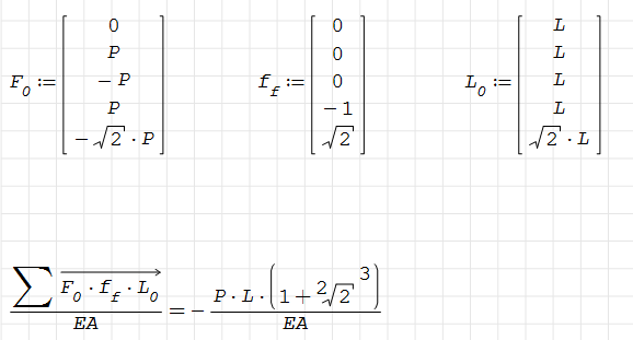

Hi~ I'm studyng building structural analysis.
When I calculate the displacement, I have to use list calculation like below using Ti nspire.
I would try this way in smath studio, but failed.
How can I calculate in smath studio?
thank you for your help.

The following uses vectors rather than lists:

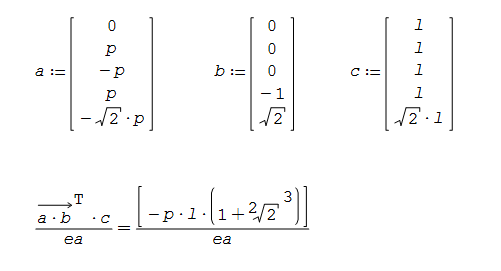

Thank you, StvMath.
I've just found the solution, but I think your way is more efficient than mine !!

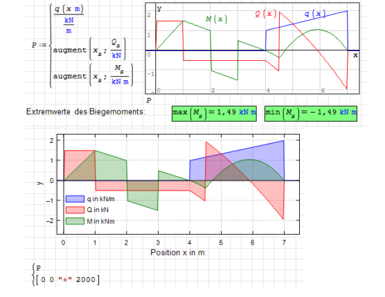

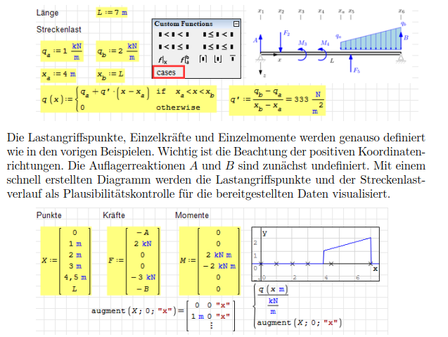

I have just submitted a book on Engineering Mechanics with SMath Studio for publishing. It is to appear early next year. The examples are already available at Github https://github.com/sn-code-inside/Technische-Mechanik-mit-SMath.
See example 5.5.
